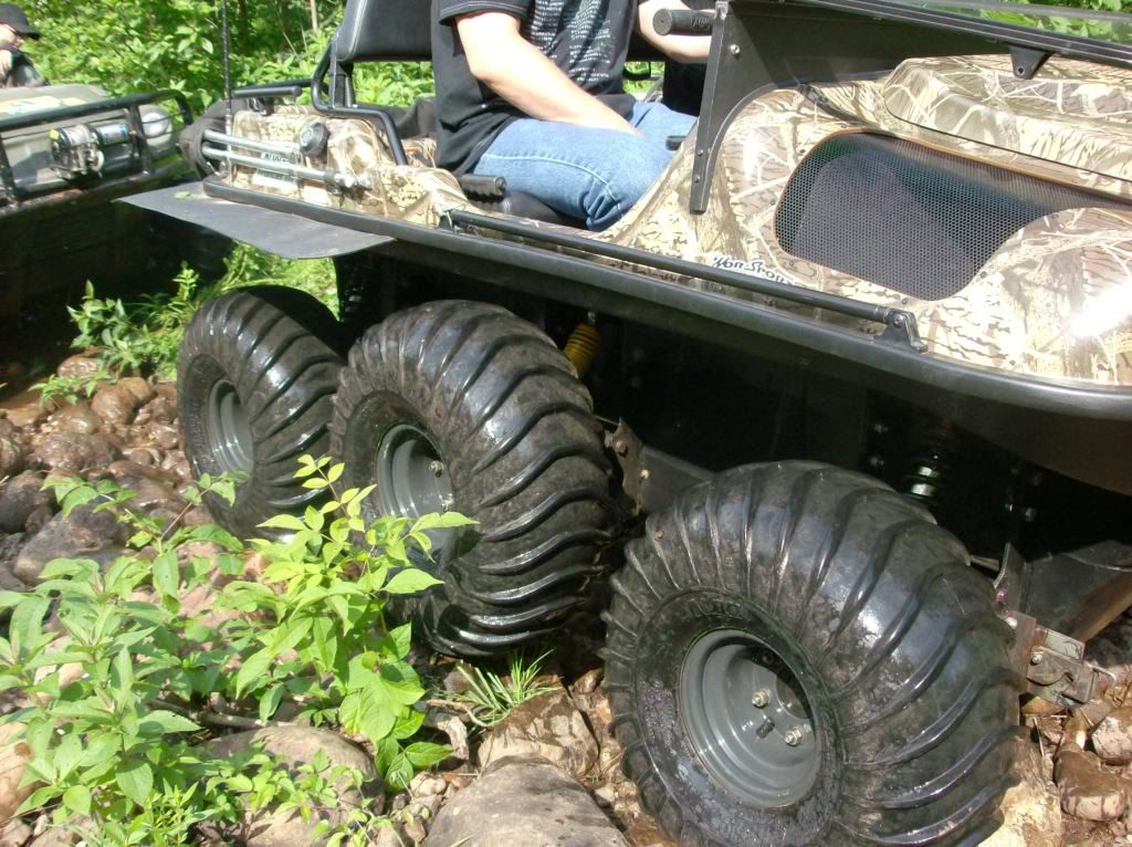

                      Argo Sprigner update!!!!
                      Hi guys, i got more pics of Argo Sprigner, my friend built couple more of these machines during the last months. Here is the pics of a 2000 Response and a 1992 Vanguard. He's just finished a 2004 Avenger and it's really a big difference compare to the old non-sprigner version... What we heard so far from new Sprigner owner is that the machine gain a lot more traction comming from the 6 ou 8 wheels sticking to the ground, they could go to place they never go before. Two of the new owner are logger and they can take tree out of bad places with more ease.
                      Martwell
                      Response waiting for suspension kit
                      Complete suspension kit
                      New long splined front shaft(new) with bearing relocated inside with a greased plate
                      New short splined middle shaft
                      Vanguard with new suspension
                      sentier6x6 Forum

                                Hello everyone, here is the vidéo that i promised you about the Argo Sprigner VS the Argo non-Sprigner... Let me know what ya think...
                                here is a pic of a Frontier6x6 in action....
                                Martwell
