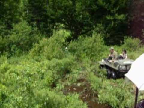

Absolutely amazing!!! Excellent work. It's like the bumps and obstacles in the trails aren't even there because that suspension soaks the shock right up. The difference between the springer and non-springer is night and day. Now if ODG could get out there with an aggressive marketing campaign to sell these on the new Argo units, they would have a winner for sure and the AATV market would really begin to boom again. Thanks for the videos.

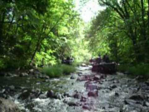

Hello jpswift, the pics was taken this week end as we were riding with my buddy. We were AATVing in as river full of huge rock and those guys were enjoying every moments as we were bouncing around... My buddy is still in the R&D with those kits but he gots couple of machine who are work rig for logging guys and they really enjoy their new Sprigner everyday at work.Originally posted by jpswift1 View PostAbsolutely amazing!!! Excellent work. It's like the bumps and obstacles in the trails aren't even there because that suspension soaks the shock right up. The difference between the springer and non-springer is night and day. Now if ODG could get out there with an aggressive marketing campaign to sell these on the new Argo units, they would have a winner for sure and the AATV market would really begin to boom again. Thanks for the videos.

Martwell, thanks for those videos. Since i have a 06 Avenger i know the ride. I was amazed at the filmed ride at the end from the passenger camera. I have one of Whipper's springer systems on my racer and it is a great ride.
I think it looks fantastic and amazingly simple.
A couple questions
(1) Has it affected the number of people that it can carry?
(2) Water handling has that part been affected?
Water testing may be one of your future tests. Would be interested in a video of that test also.
Just by the design the traction should have improved due to more wheels staying in contact with the ground.
Again great video, looks great and keep the videos coming.

Hello everyone, thanks for your nice comment on mu buddy's sprigner kits and sorry for not responding sooner, i was away from the computer and working a lot.Originally posted by lewis View PostMartwell, thanks for those videos. Since i have a 06 Avenger i know the ride. I was amazed at the filmed ride at the end from the passenger camera. I have one of Whipper's springer systems on my racer and it is a great ride.
A couple questions
Lewis
Whipper, i got more videos coming, i'm working on the next one where we gonne see the Frontier Sprigner in water
... To help you wait, here is one of our last ride(last week-end), you can see both the frontier and the Avenger during a river ride...
For the capacity of charge, it remain the same because the suspension is design to be ajustable, so you can make if firmer if you need to.
He feels his Frontier seem to be less stable in the water but i told him that i also have to be seating in the middle in my Bigfoot to be level in the water. This was the first prototype that was made and the suspensions plates underneat were bulletproff !!!(too thick) Since that he reduce the thickness of those plates, reducing the weight without compromising the solidity of the kit.
On the Avenger, he put all of the 8 wheels at the same lever so all of the 8 shocks will work together with the same pressure. My friend didn't wanted to put more stress on the 4 innner
spring to keep it easier to turn, he prefer more traction with all the wheels on the ground.
The next time that we go riding together, i will stole his key for a little joyride.... stay tuned

Hello everyone, here is the video where we see the Frontier Sprigner swimming in the water. Look in the vidéo as 8:00 time and you will see it. From my point of vue, he was a little more in the water than my Bigfoot. But still floating...
My buddy is working on a new lightweight version of this kit. As soon as i got some more pick of it , i'll posted them.
