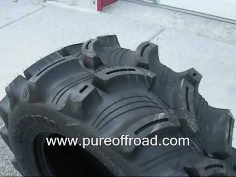

The one other thing that should be mentioned about the executioners.
The executions tread (teeth) have a slight smooth forward taper. Which causes the mud to curl off , as will water and not be carried like a 90 deg squared tread.
My preferred tires are the Kenda Executioner, and the Interco Swamplite. For the price, performance and lifespan.
There is another brand/model of tire and better than ASX . However they are very expensive.
It's called Power Grip Mud B*itch.
The third video has the best examples of the MB performance.
