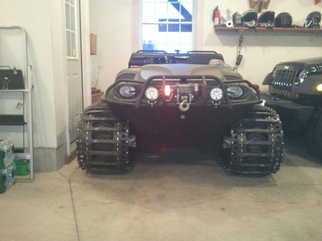

                    I have used the EXIDE ORBITOL marine battery in my polaris ranger for the last 3 years and it worked very well..I powered a winch,heater, radio, and 4 spotlights. I ran a pigtail connector from the battery and plugged into a trickle charger when not in use. this setup has never let me down and I would highly reccomend it..I have since put an EXIDE in my Frontier and the fit was perfect..I placed some thin foam sheets on the sides and it is very snug and stable.
                    I know that this Exide will be more than I need for running my lights and winch!
