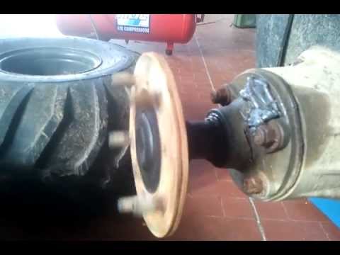

    The Avenger is a model 700 with 26 hp Kohler engine, the clock shows only 84 hours but the previous owner used it regardless, the frame is a little 'rust and all the controls are to be calibrated ... but the worst thing of all is that the Argo was probably used as a toy for a child ... and must have taken some bad shots at the wheels, this is the movie that show how the right shafts turn :
    What do you advise me to do? just replace the axle shafts, or even replace the bearings?

    Welcome, Luca. That is a nice machine that you have there.
    As you have surmised, that axle is bent. I would replace it and the bearings if the machine belonged to me.

      Good find on the Argo Avenger. I'm sure that these machines are far and find where you live. Replacing all of the bearings and the axles that are bent seem to be the first major step.

                100_3922[1].jpg100_3925[1].jpg100_3921[1].jpgI would replace all Axles and Bearings, in 2010 Argo came out with a new style Heavy Duty Axle and Bearing. These are used in all current models.
                You can retro fit your 2005 Avenger with these newer Axles and Bearing (If your repalcing them anyways)

                    @ Hurtmudman thanks, this is what I want to do, an upgrade instead a repair... but.. the left axles are good...:-( . What is the best online shop? do you know if there is a good web shop here in europe? many thanks

                        They may be able to give you a better price...put to upgrad all 8 axles and bearing will cost you around 2000..
                          I would replace the bent axles and upgrade to the HDI bearings, but would not bother with the other axles until you need to.
                          Also, you could check in with Tim at Adair Argo and see about his adapter kits for the front and rear bearing extensions (HDI Bearing adapters)
                            You can save the money by bending the axles back to its true state by using a bench press. CBASS http://www.6x6world.com/forums/gener...bent-axle.html posted a video like two or three weeks ago of how to do it. There are other methods to fix your bent axle problems on the site from other members that are just as good. As for the bearings,, for sure,, just like everyone else,, I would replace them if I owned the machine.

                              I will try to straighten the axles... but I will use the argo also in the road and I notice that bent axles made really unconfortable the ride...
                              I have another questions: are the hdi axles compatible with the old bearings?
                              Is my front and rear bearing extension compatible with the hdi axle and bearings?
                              This question is because in the buyargo.com website they have a complete kit for front and rear axle that cost 331$ every axle because there is also the alloy case. But I really need this case? It seem the same in my avenger...
