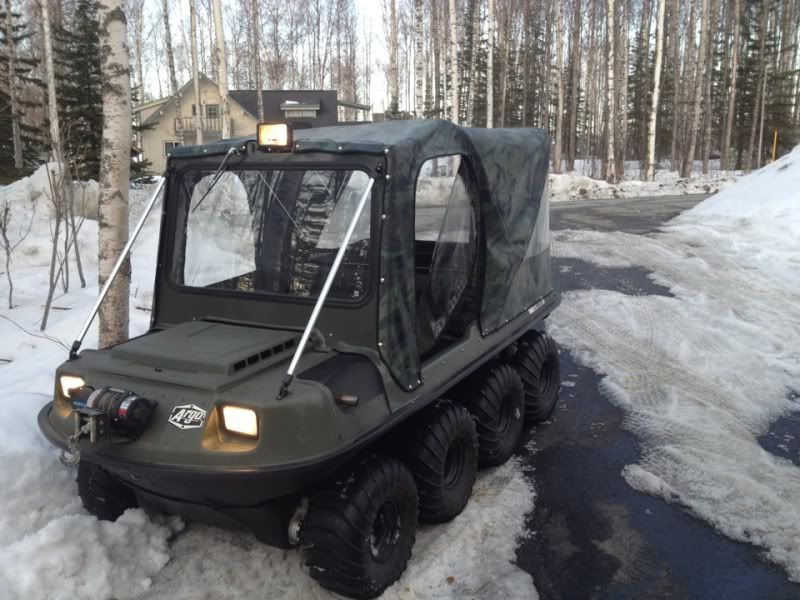

                Thanks for all the help guys. I went an picked her up this afternoon.
                Took it out for a quick spin and couldn't be happier, I came across a deep pond and she plowed right through.
                I couldn't be happier. I plan on doing some of the maintenance this weekend so i know what and when its all bee done. Than im ready for some spring bear hunting.
                Maybe some cool LED light bars down the road
                2003 Argo Conquest
                Wasilla, Alaska
                  Congratulations. It looks great.
                    Great looking machine! Hope it gives you years of service!
                      Grats on a sweet looking ride.
