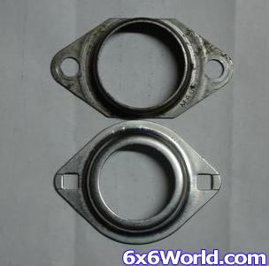

They did not have the correct inner bearing in stock but I modified the flange of the one they had and made it work. I just cut out the ends of the holes since the bolt spacing was a bit narrower than the original. I had planned to just use the old flange but couldn't because the new bearing was .05 larger than the old one
I just drilled the holes larger and cut where the black lines are:
The original inner bearing number is a Nice 6916b with a 2 inch outer diameter and a 3 1/4" bolt spacing. That would have been $24.65 if they had them in stock.
