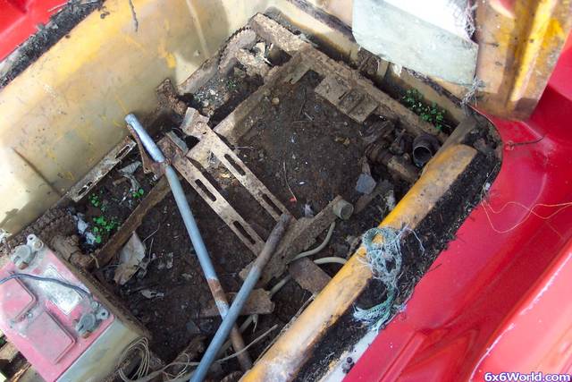

I am working on an old 297 and I am having trouble with the engine mount. The one I have looks home made and doesn't seem to fit the correct way. Does anyone have a pic or have a mount for this machine? When I put the engine in the exhaust hits the back of the machine where the cover mounts.

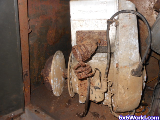

Does your exhaust slope down like this?
Here is the mount (upside down and crosswise laying on the frame rails).
I'll look to see if the manifold is any good, are you running the stock belt?sigpic

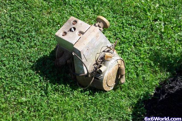

Here is a oriented picture showing slight down turn, manifold is not good though.
You may need to slide the trans and engine forward and replace the short chains to gain clearance.sigpic
