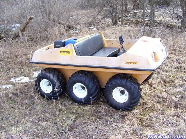

Larryw has them on his
His 208 has no external muffler, the first gens did have an issue with melting the rear tire if over inflated.sigpic
