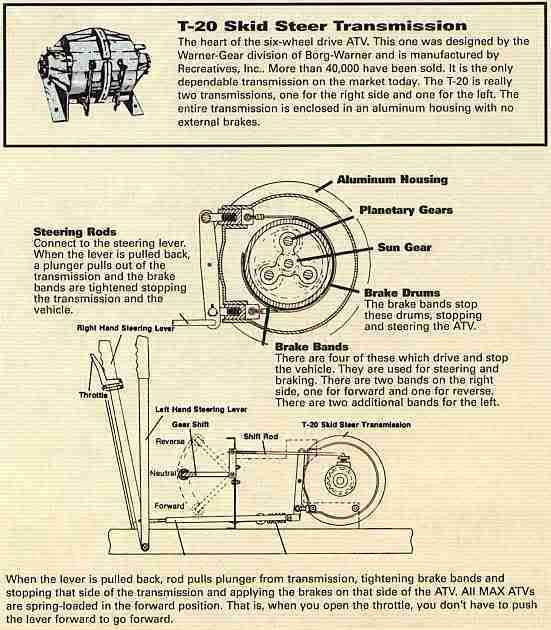

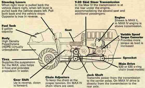

Amphibs are powered in many different ways, and each brand does it a little differently. To go with the big 3 that are still produced: Argo and Max run a horizontal shaft motor, cvt clutches to a trans, then chain and sprockets to each wheel. Mudd-ox uses a hydraulic pump and industrial motors along with chain and sprockets. A zero turn mower's components could be used, but they are much lighter duty and precautions would need to be taken. The machine would need to be kept as light as possible and not sped up. Most people just wouldn't be happy with a top speed of 6-8mph.
is there anywhere u can view these and their set ups.is there a part number that i can view to see what it even looks like. like i said all this just hit me this morning just courious not building or working on these just interested and wondering.
just wondering is there a way to run a vertical motor on the t20 trans or any other trans.thanks buggyman for the tour and the link. all motors i have seen have been horizontal just wondering there is a way to put a vertical in one. thanks for all help
just never knew how they worked or how you could get a vertical to work. thanks for shedding some light. guess if you was going vertical you would need the one with the three shafts coming out or not. plus i was wondering after i saw that set up for the right angle gearbox and vertical engine if it would cut back on some of the performance and power. thanks again for taking time out to help.
