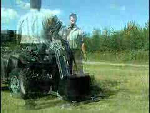

Hey guys, if you notice the 6x6 Argo has outriggers to take up the the majority of the load when using the bucket. The second photo of Salamanders, has a blade on the front, aka spade. This also takes very much of the load off the vehicle. When utility trucks use their booms, they always use the outriggers to take the load, because the booms through the towers are connected. Yep there has to be some counter weight, but with the use of the outriggers or the spade, this limits the amount of counterweight needed. Just my thoughts guys.

I like how it mounts and releases in 2 minutes. I'm betting these things aren't cheap; but probably cheaper to buy one with a new Argo than buying a similarly equipped Cenataur.06 Bigfoot
That C-Ros loader looks pretty cool, but for the $5000 they want for it on their website I can buy a complete Power-trac loader. Still, this design gives me good ideas for my Max. I think I can fab something really close to this for about $800. Thanks for posting!

Ok guys,I have been building my own atv accessries for 7 years now and this is what I've found so far: ever notice how manufacturers of these things are always moving loose dirt around?Thats because we're talking about atv's not d-8 dozers.I think the hoe with outriggers is the best of what has been displayed here because the weight/workload of operating it is carried by the outriggers.Just don't expect it to have the capabilities of a 580-c case and I think you will be very pleased with it's performance.Beware ANY product that requires its weight to be carried by the atv while operating it,this can lead to premature wear to the machine.I have a dozer blade for my Hustler and I am sure that it has aided ,if not caused two breaks of my front left axle.DESTRUCTION is just a couple of vowels down the street from DISTRACTION
I wanna loader too!
I'm toying with the idea of putting a loader on my AATV too. It won't be for digging, just moving mulch, loose dirt, snow, etc. not more than a few hundred pounds. Assuming I ever get to it, I'll be using the same basic design and geometry as a Bobcat skidloader with the loader hinged all the way in the back and above the body, that way there's no need for any outriggers.
