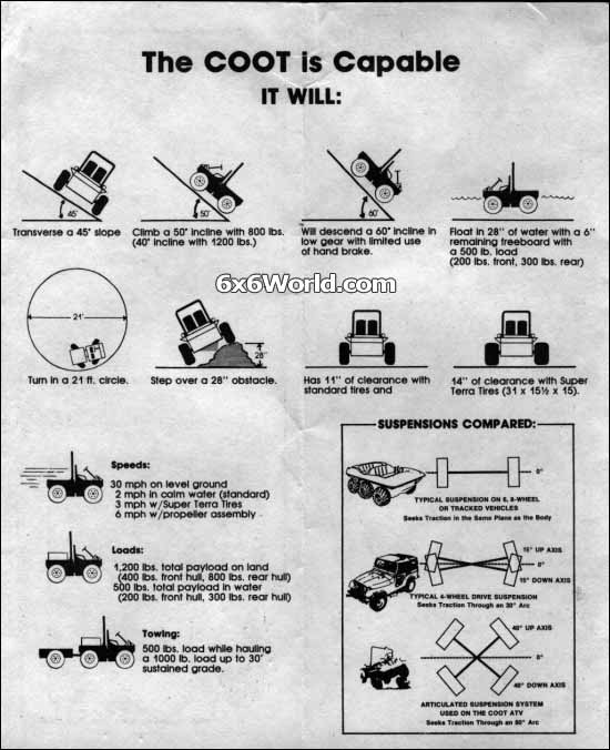

Sounds like your looking for a Coot http://www.6x6world.com/images/broch...ting-atv-3.jpg
I've personally pinned my clinometer past 45 on nearly every outing. There may be machines that climb better, but I've never driven one that was more stable!
Also you get your heavy duty tractor durability, and 6mph insane torque top speed lol.
