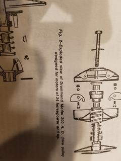

I have a manual that may have the process covered. I will check tonight and see.Stuck in the seventies- not in the swamp.
It looks like it may be a Drummond clutch, but information is scarce. All I have is an exploded view. It looks like you have to take the clutch apart in order to get at the inner pulley which may threads in the center. I'll try and post a picture of the view.Stuck in the seventies- not in the swamp.
Do you have any idea how it comes apart? I tried the hex nut on the outside and so far nothing. I don't want to hammer on it.Originally posted by Don View PostIt looks like it may be a Drummond clutch, but information is scarce. All I have is an exploded view. It looks like you have to take the clutch apart in order to get at the inner pulley which may threads in the center. I'll try and post a picture of the view."Racing is life. Anything that happens before or after is just waiting."
I'm thinking the hex nut is the key. I'm not sure if it spins out of the cover or if the whole cover spins off (pretty sure it's the former) but that would give you access to the weights and at least then you'd be able to see more of what you're up against.Stuck in the seventies- not in the swamp.
