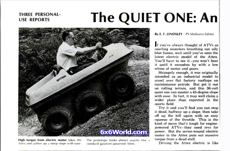

            Attex built an electric machine in the late 60s or early 70s. I have the Popular Science article somewhere, and I'll find it and send it to Mike. Someday I'm going to straighten all this stuff out so I know where it is!
              Don, I never knew about that electric Attex.....that's really cool! Mike, I remember that electric Amphicat on ebay.....it was listed 2 or 3 times, I believe. I came across the video of it on Youtube. If I can find it again I will be sure to post it up.

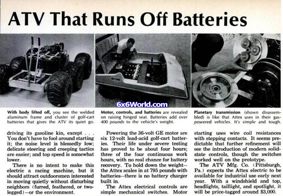

                    Here's the electric Attex article that Don was so kind to share with us from the November 1970 edition of Popular Science Magazine.
                    I also uploaded it to the Attex brochure section here: Attex Brochures and Literature
                    Talk about a rare 6x6. Could you imagine having an original one of those.

                        Thanks Mike, that's sweet. Gives me some numbers to work off of. I don't need 4 hours of run time so I can use half the batteries, though I'll probably use 4 12V to get 48 volts for more power. Those old GE motors were pretty heavy for their output I think so a modern pancake motor like an E-tek would help with weight and a modern controller should be more efficient than the stepping contacts they used. If the price of lithium batteries ever comes down to earth I could upgrade and lighten it up even more. Can't wait to get my hands on a vehicle. Are some better than others for this? Lighter weight, more room for batteries, etc? I suppose I'll just have to take whatever comes my way and make it work.

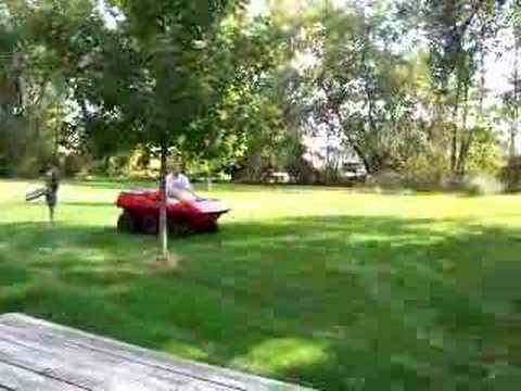

                            Here are the three electric Amphicat 6x6 videos that I came across on Youtube.
                              Nice! I sent a message to the guy to find out more about what he did, don't know if is account is still active since he was trying to sell it back in Oct.
