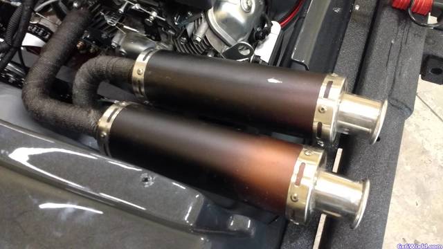

Building the exhaust with scooter mufflers.
