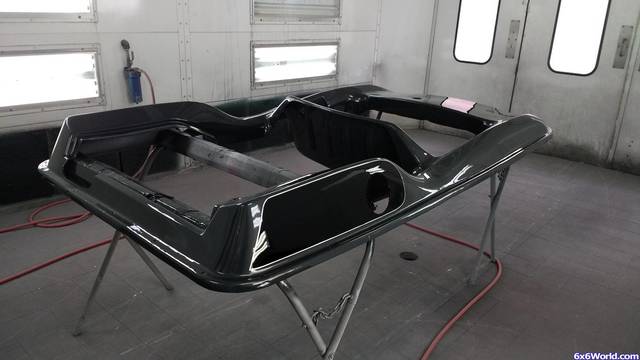

PAINT!
Top is painted

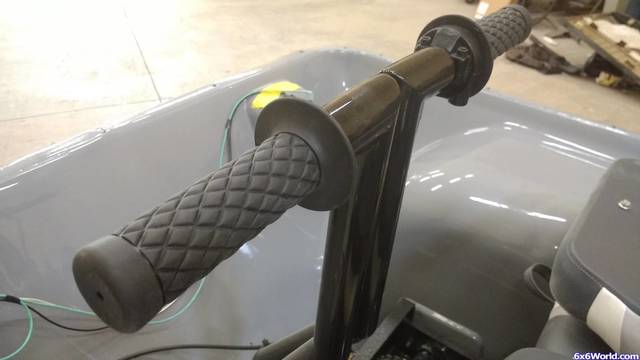

I finally gave up on "acquiring a taste" for the grips that were pink but supposed to be red. These are mo' better.

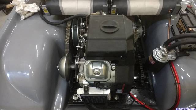

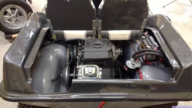

Engine is in. Trans is in. Seats are in. Battery is in and wired. So close... So close.

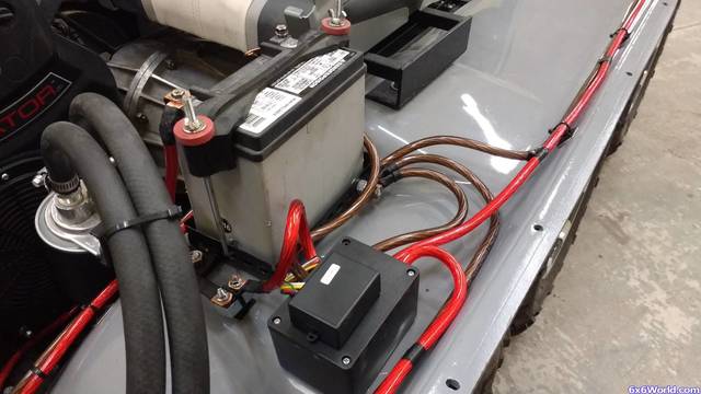

Here you can see the oil filter relocating kit. Bracket is tied into battery tray brackets and then double sided taped. It's good. MAN, that thing leaked a couple quarts of oil all down into the tub before I realized that there was an interference between the Predator oil filter area and the relocator kit keeping it from sealing on the O ring. AARRGH!!! Cut off wheel. Grinder. Clean. Fixed.

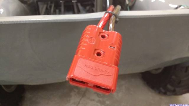

Wiring up the quick connects for the front-and-back winch. These things are pretty cool. Now I just need to figure a way to cleanly get them through the tub.

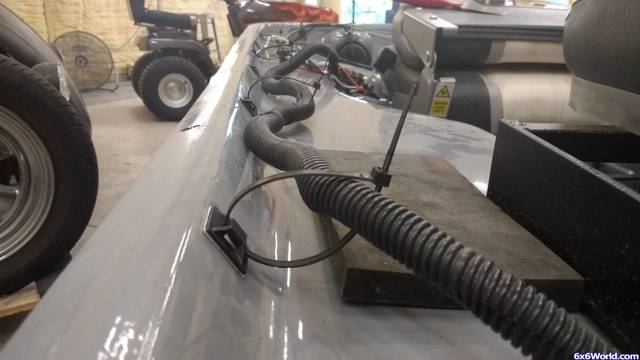

I've never seen these before but Amazon had them. They're self-adhesive zip tie posts. Perfect for the Hustler. ZIP TIES! All the wiring will get loomed before the top goes on.
This is by far one of the cleanest builds I've ever seen on a 6x6... That black top is so gorgeous I've got to ask, what did you do to make sure the paint will stay adhered to the HDPE? Burn off the waxy coating, flexible additive in the paint? I've gotta know your secrets for the body I'm going to swap onto my machine.
Any paint manufacturer has their own plastic primer. I used a product called Bulldog. It smells like bunghole but works well. I sanded the whole body inside and out with 80 grit on a DA, then 180. I did all my body work at this point- filling holes with fiberglass filler and scratches with a glaze filler. Then degreased it all really well, sprayed a coat of the bulldog, then thick primer. It was like priming astro turf. Then I sanded it with 180 again, primed again, then sanded with 400. LOTS of work, but it's really not too different than painting a bumper on a car, other than smoothing out the texture.

I guess I was in the zone this weekend. I got a bunch of stuff done and a now just a very short list ahead of me to the finish line. I got all the winch wiring done, which I had been dreading a bit. The winch kit came with 10-or-so gauge wiring, which I thought should be bigger, but I needed to open up the relay box to remake all the wires to the 4 gauge I have. So, I got that knocked out, zip-tied it all down and magically, it works! I like it. As for now I'm just reduced to pulling stands across the shop. It entertains the children.

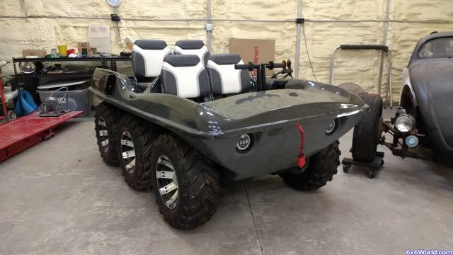

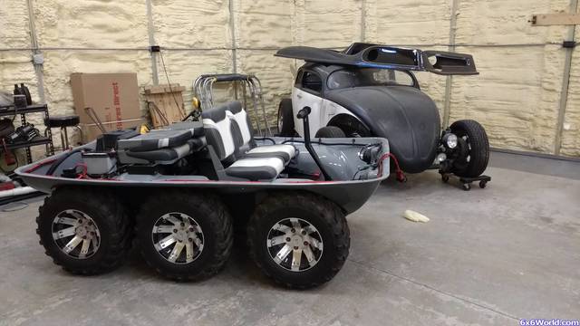

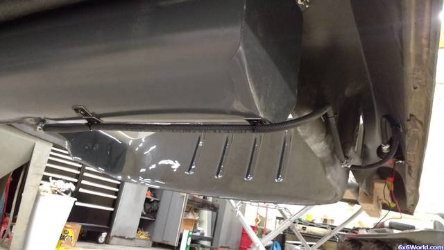

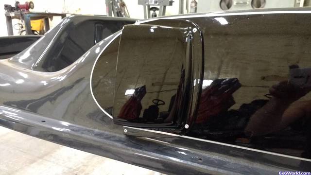

I got the side scoops painted to match the stripes on the body top. Even getting painted in my shop at home with the wrong sized tape, they turned out pretty well. I got the body band wire brushed (It was already pretty rusty just from the few months since I built it) and epoxy primed a couple days ago and took it up to the Rhino Liner shop. It should be done Tuesday. I had some epoxy primer left over so I shot the fuel tank as well. This allowed me to get all the fuel lines put into the body top with the pump and shut-off valve today as well. I thought, "Well... I guess I can put the top on now...?" It's been so long in pieces with such a long list of to-dos it was weird to get to this point. So, I put the top on. And it looks awesome. Once the body band and bumpers assembly gets back from the bedliner shop it'll be just down to little things like... a gas cap, and a new drive belt (which will be a bit of a hiccup since I need a different size), and to rejet the carbs. And the exhaust. Aaaand I have to fiberglass the decklid. Aaaaaaaand I have to get some solar panels to make into that decklid to charge the battery... and that may be it.
Maybe...

Fuel system in

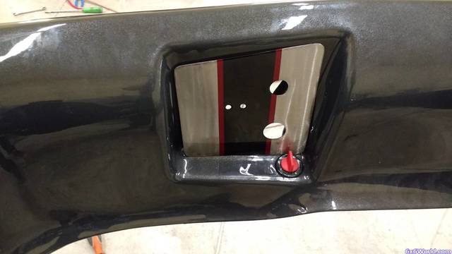

Switch panel and fuel shut-off. I figured that, while they should be close together, they should not be "THAT" close together. This way if there is a leak from that valve, it goes down into the tub WITHOUT dripping over a fuse block.

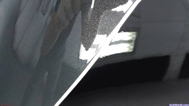

Chameleon-like side scoops

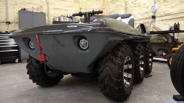

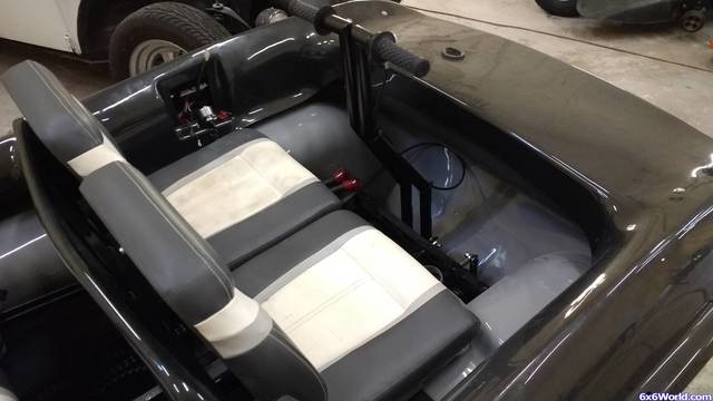

I'll take the body top off ONE more time to wet sand and buff it so that I don't make a mess in the tub, but that's pretty much it. There she is.
I'll drill some holes in the top and route the red cables through them with grommets. It won't be left all hillbilly like that.
The lighter gray inside is perfect for the clean racecar look.
Those valve covers need attention. Maybe black wrinkle finish. I thought about red but they'd look like boobs...
