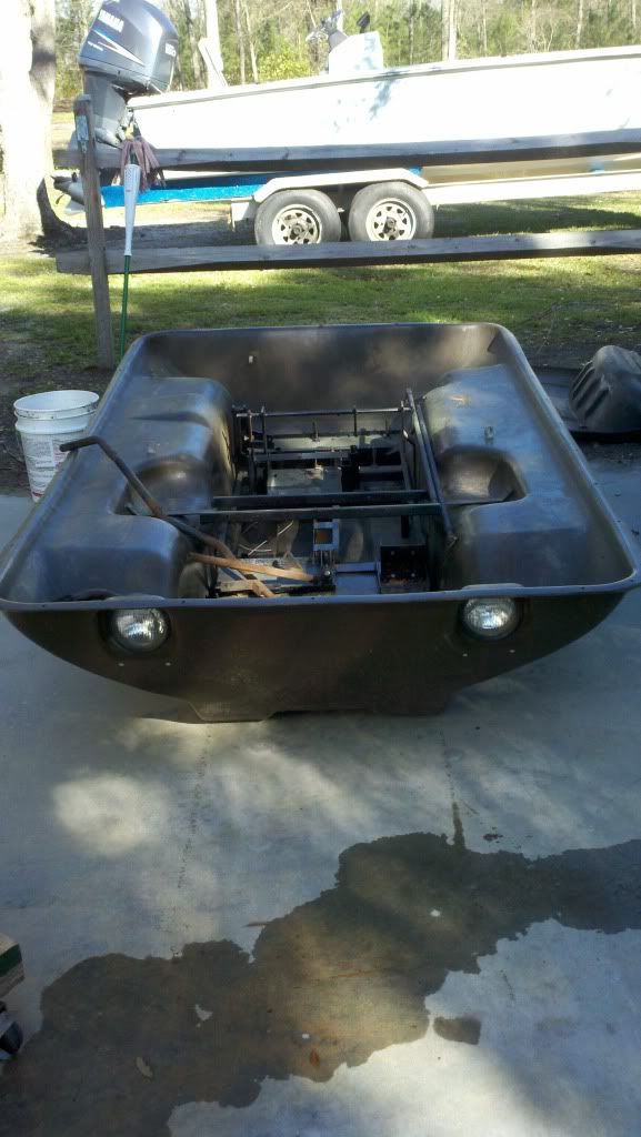

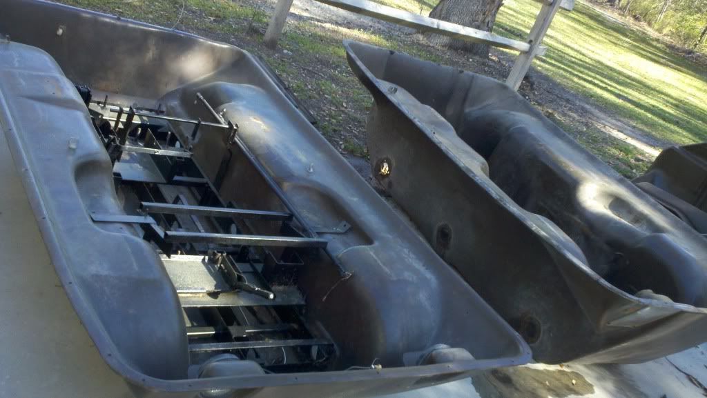

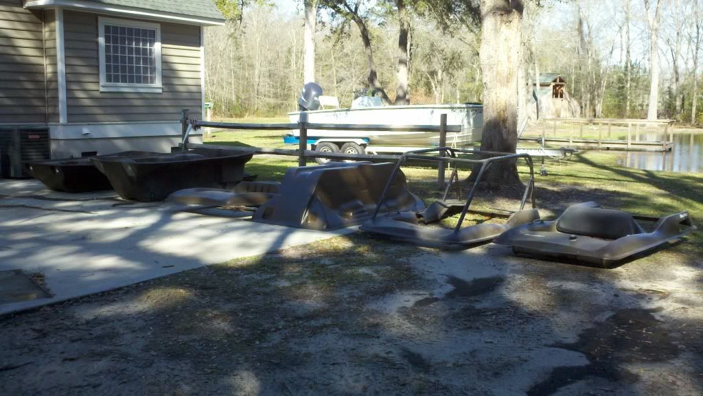

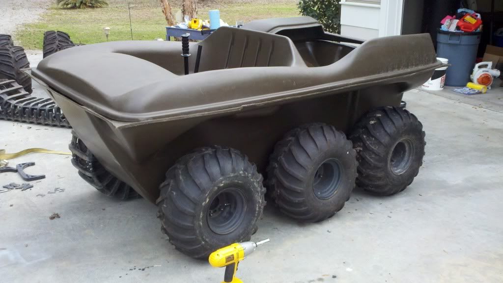

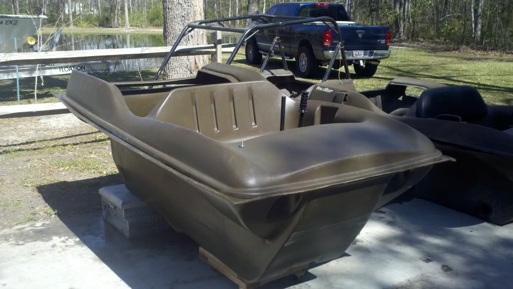

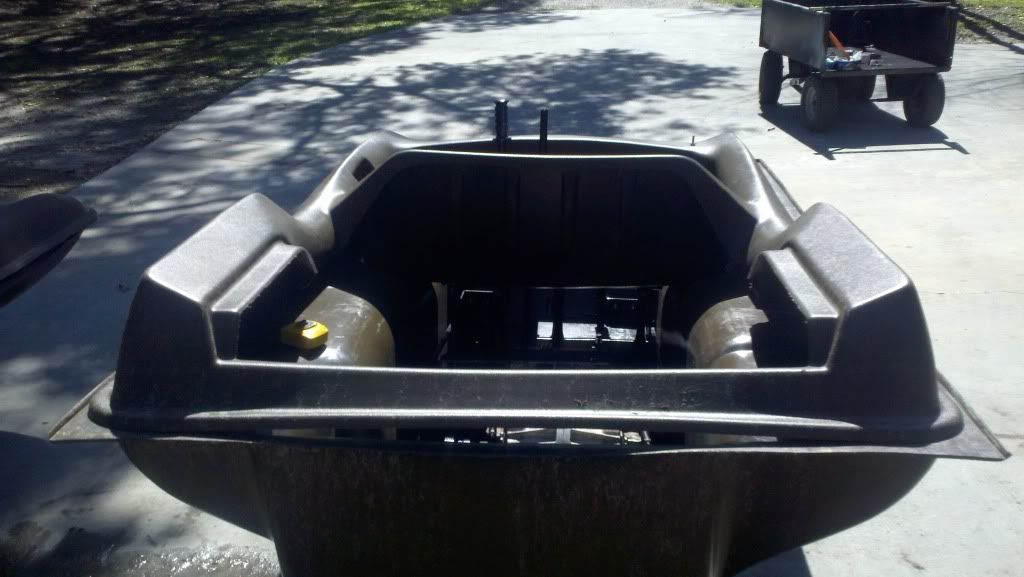

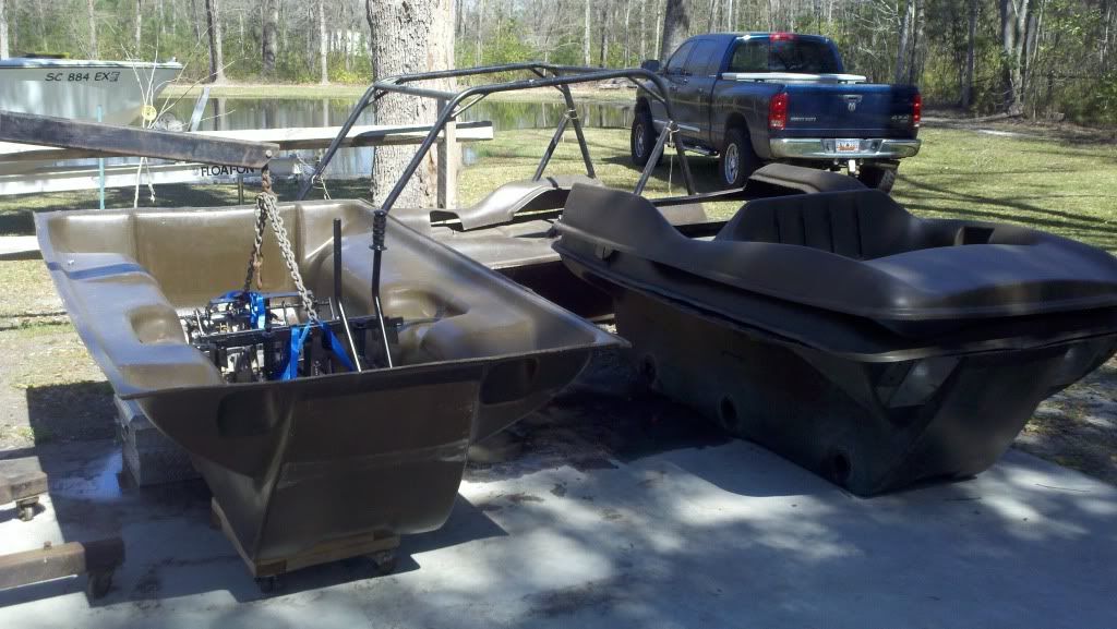

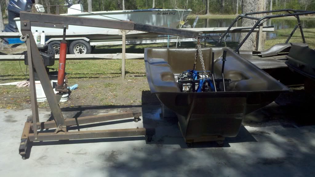

      I was just goofing around so I figured I would try my 950 frame in my old 980 tub. All of the axle holes matched up perfect. Just have to raise the seat bracket about 6".
      HUSTLER 980 NOS BUILD
      HUSTLER 980 TRAIL MACHINE
      HUSTLER 950 PARTS MACHINE [

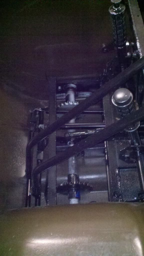

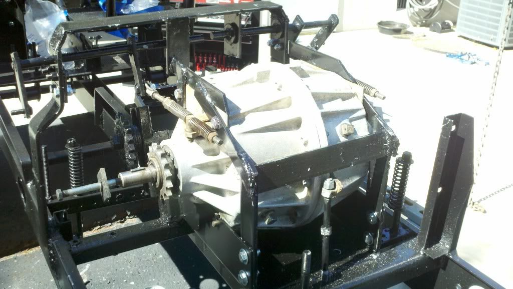

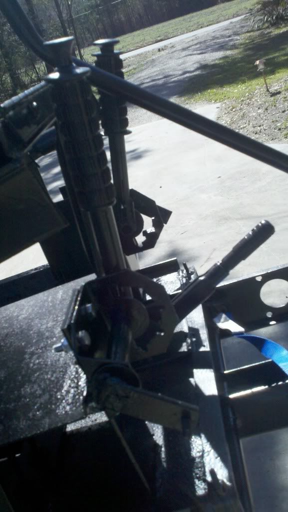

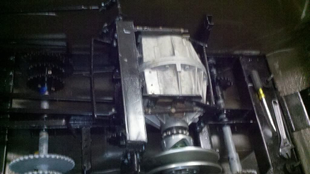

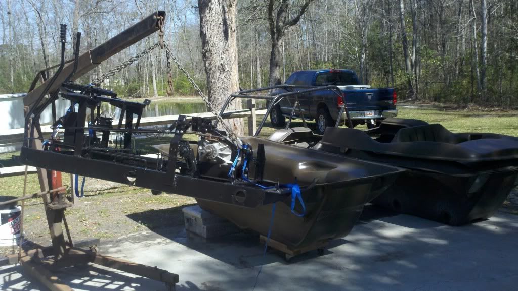

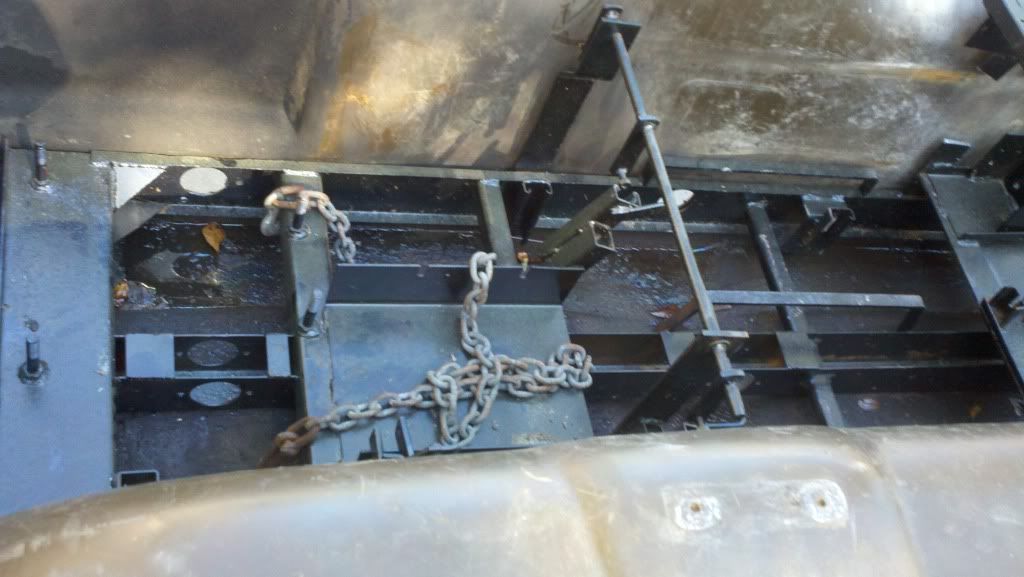

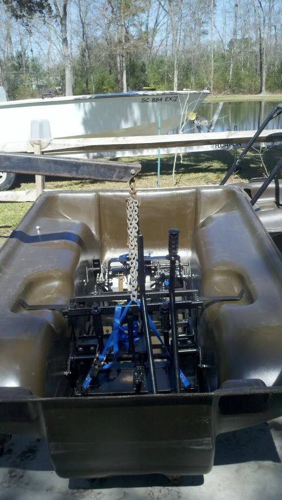

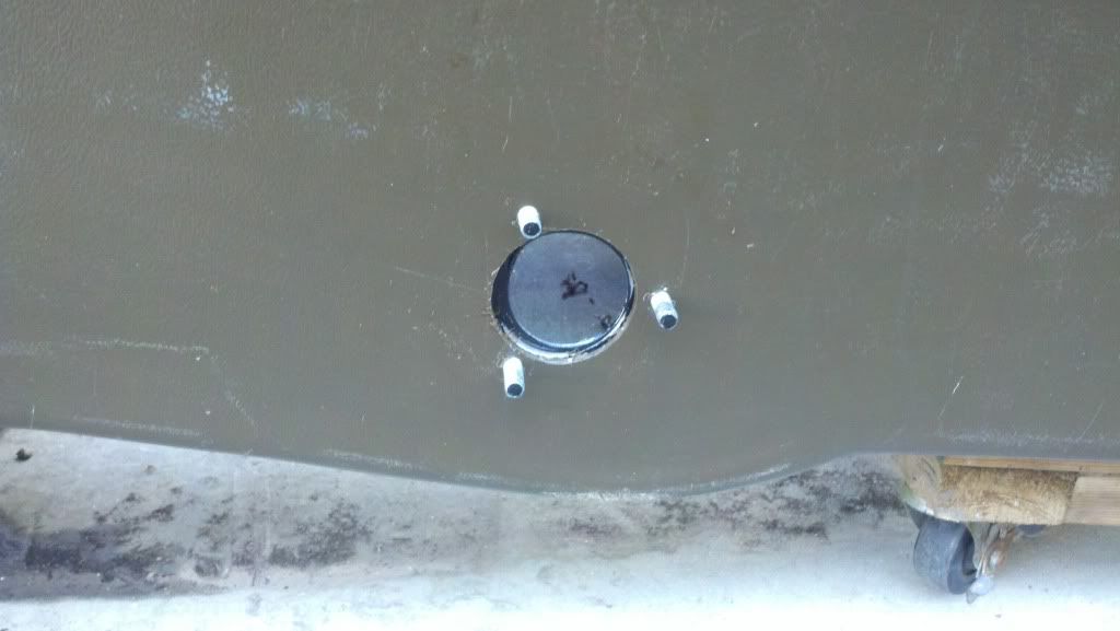

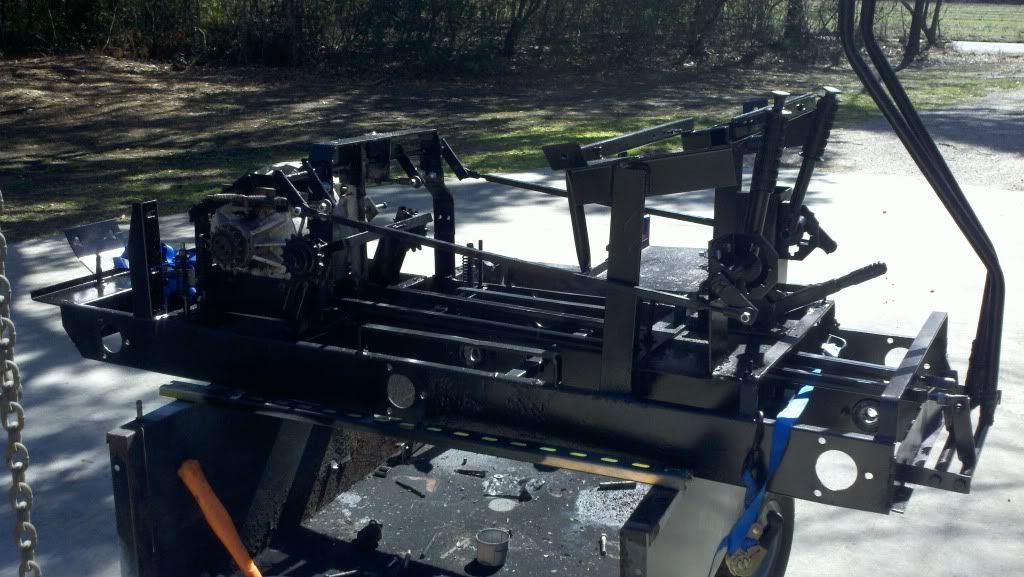

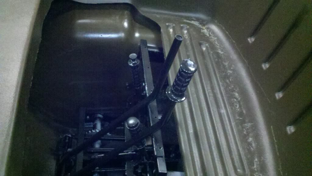

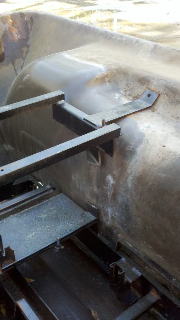

              The transmission mount should be rock solid. It is tied in to my split shifter linkage. I built the assembly as one piece and it held in by 12 bolts but is completly removable linkage and all should ever need to make some repiars Ill have everything out the way to do so. The back two tensioners are spring loaded and the front to are manual but are easily accessable. I used a 2 3/8" hole saw stuck inside the bearing flange to make my pilot hole and a 2 3/4" saw to cut out the hole for the flange to fall into. Dana67 has a jig made to do this and was nice enough to offer to ship it to me if I needed it. Im was on time crunch so this worked out just as well in a pinch. I just want to thank everyone for all of there help in answering questions and offering advice throughout this build. 6x6world.com Rocks!!

              • #37
                Looking two nice. The t-20 mount looks very robust too. I'm sure it will hold it in place.
                • #38
                  Great work! What a fast and high quality build you've got going there. I've got your exhaust duct all set and I'll be able to ship it out tomorrow so hopefully you'll be able to get it set up this weekend. I love your split shifter setup too......I might have to copy that on my BIGFOOT in the near future. Keep up the good work!
                  • #39
                    Nice work man, very robust structure for the t-20. Looks like this is going to be a prime example of a N.O.S. Hustler.

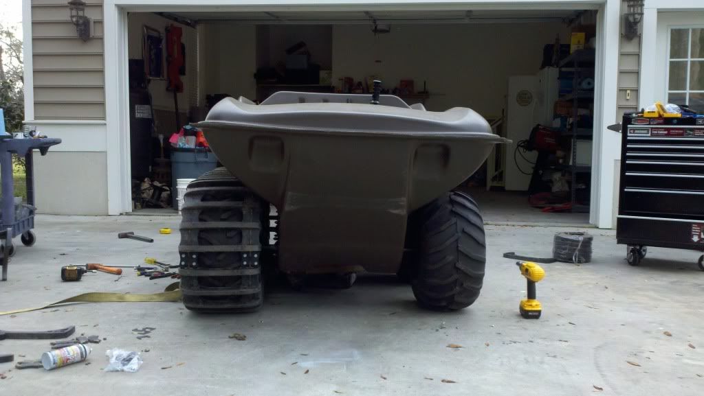

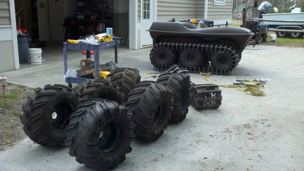

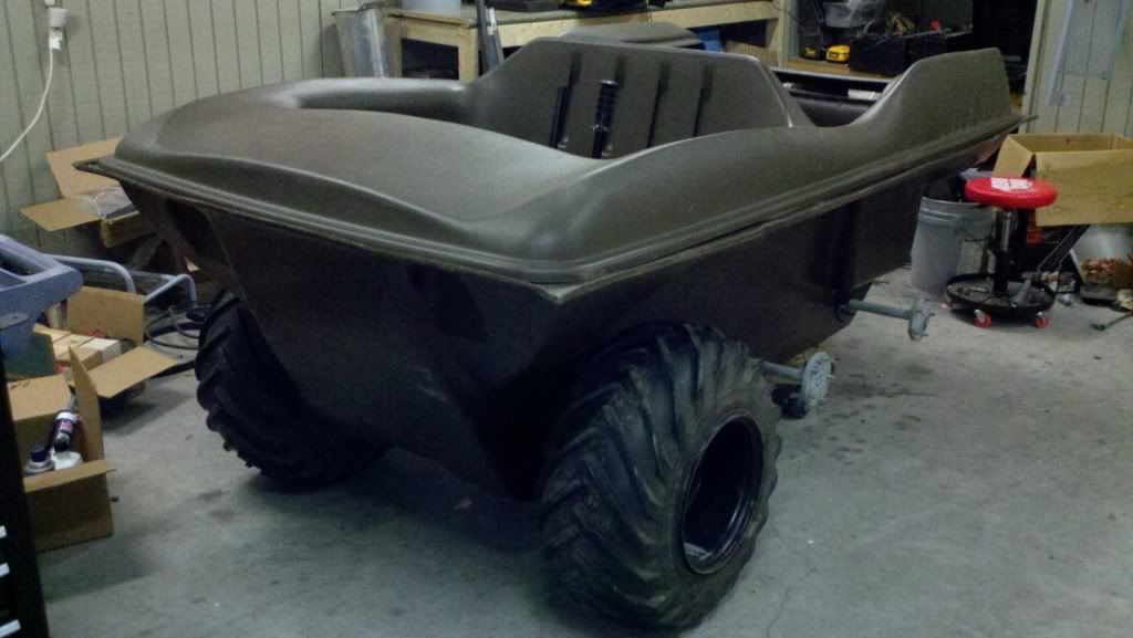

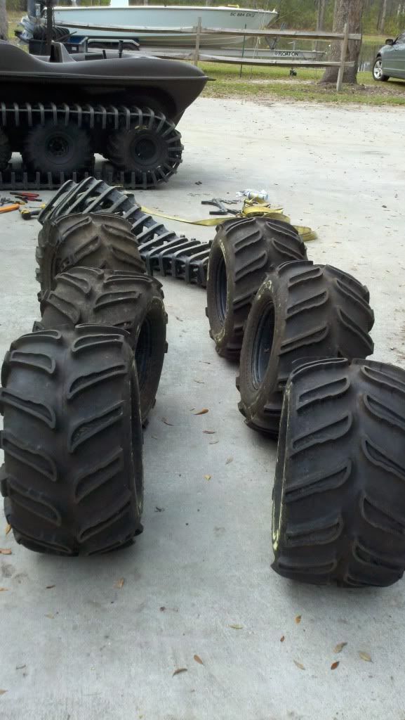

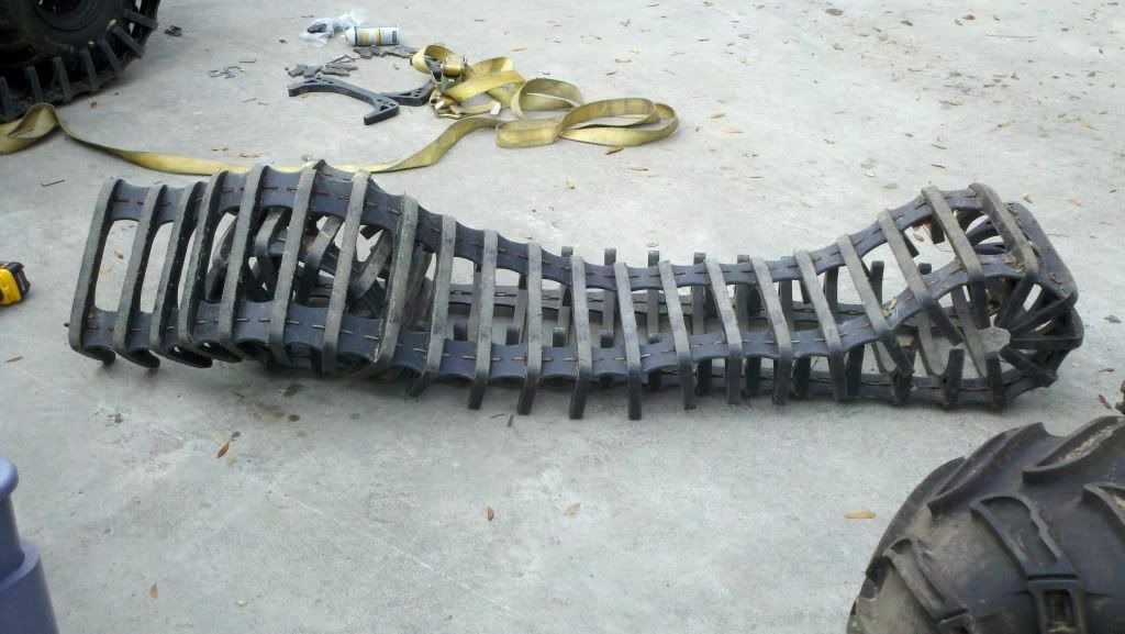

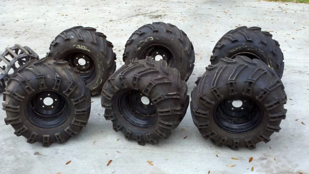

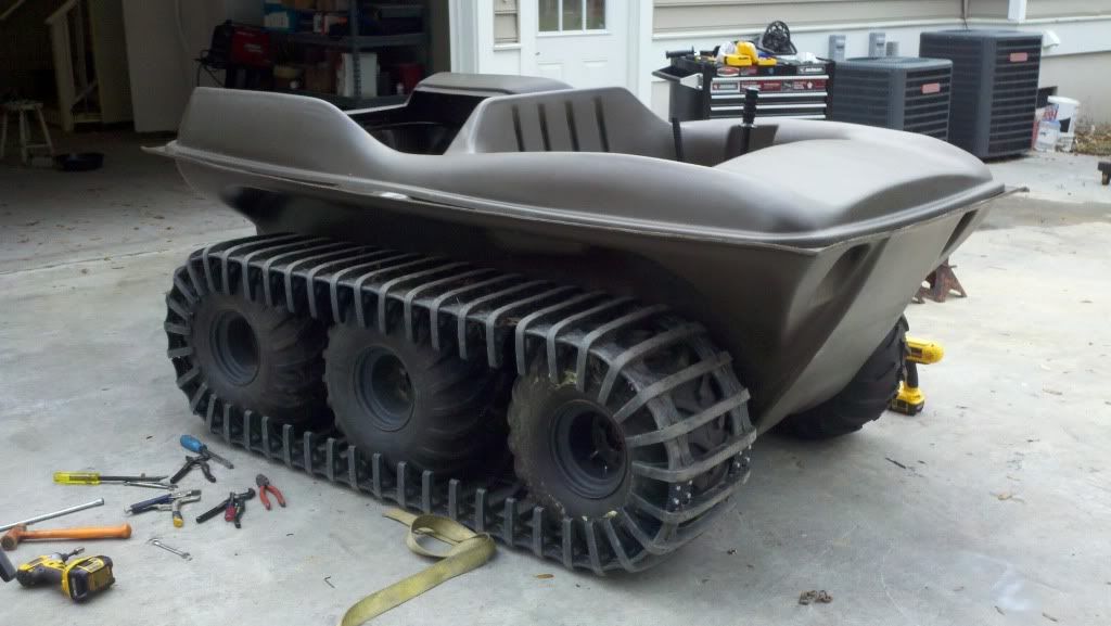

                                Ok so I couldnt decide on a tire choice for the Hustler. When the opportunity came available I bought a set of Adair Swimming Tracks on 25x12 Rawhides and a set of 26" Vampire ASX's on Klock wheels. Overall I think it looks killer with the Adair tracks. Ill know how they perform in a couple of weeks.
