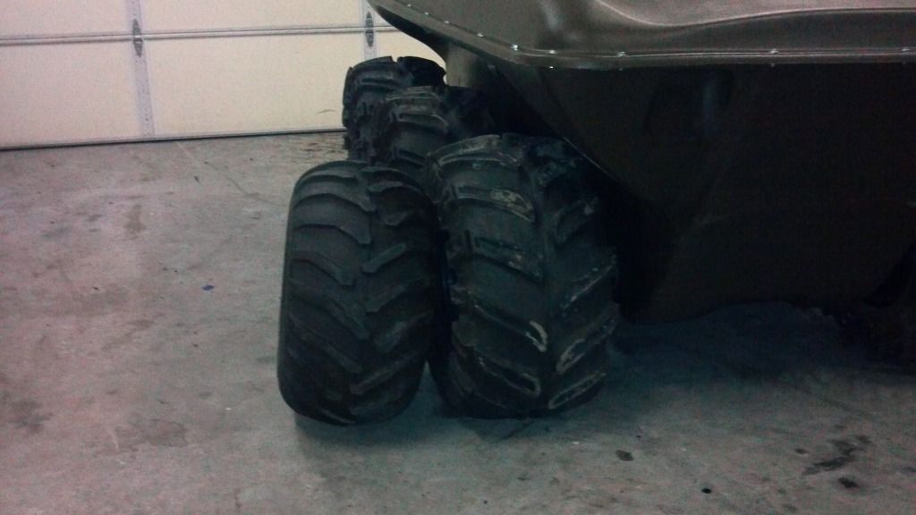

    21x11 would probably be about close to perfect on a 950. I almost think a 22" would be to tight on clearance after you put the tracks on. I just talked with Mike from Adair Argo and he said they do make tracks for those 11" wide tires. You'll probably be looking at paying 2 grand or more plus shipping for just the tracks without tires.

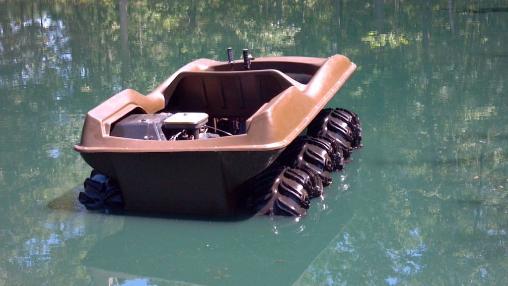

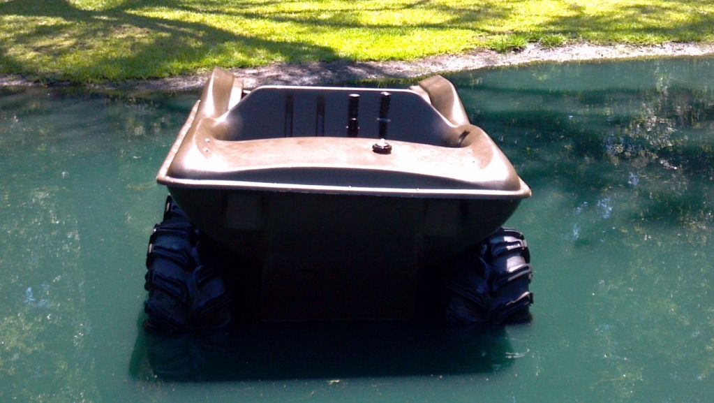

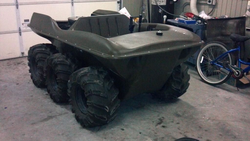

                      It is leaning to the left side because I had 1"of spacers on the left and no spacers on the right which actually makes it off balance I fixed this by adding 2.5"wide spacers all the way around which will also provideconsider clearance for my Adair tracks. By the way if you never dealt with Adair Argo sales man they are top notch. Mike has really bent over backwards trying to help me out the few times I have dealt with them. I will definitely not hesitate to do business with them in the future.

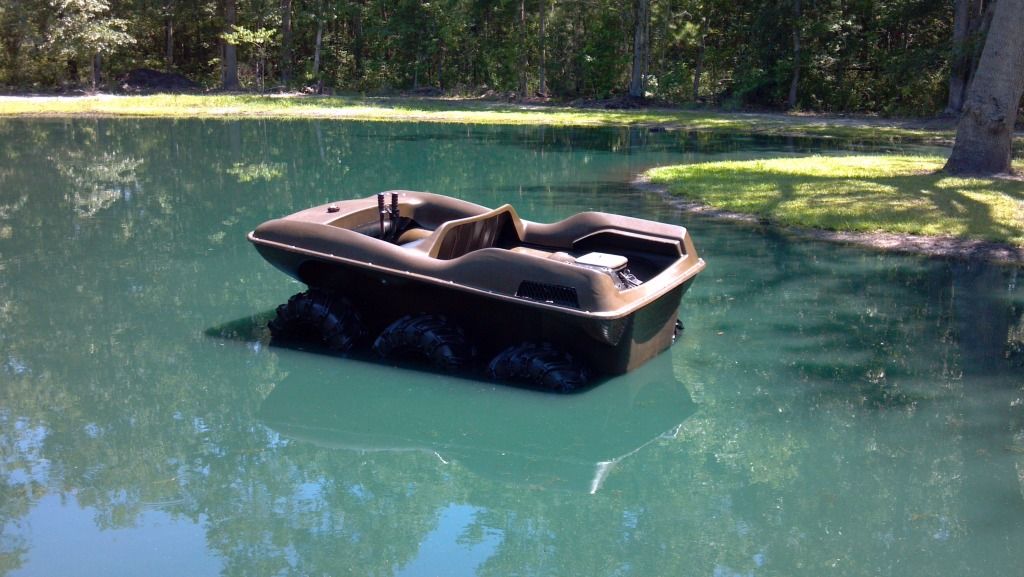

                            First Video with the Adair Tracks on the Hustler 980. They swim better if you just rev it a little more than idle. If you give it big power it just burries rear of the tracks in the water. They do turn very easy, ride great, and are suprisingly quiet. They are not nearly even close to being as fast as swimmers as my ASX'S though. That's the best tire for a Hustler 980 I have run to date.
