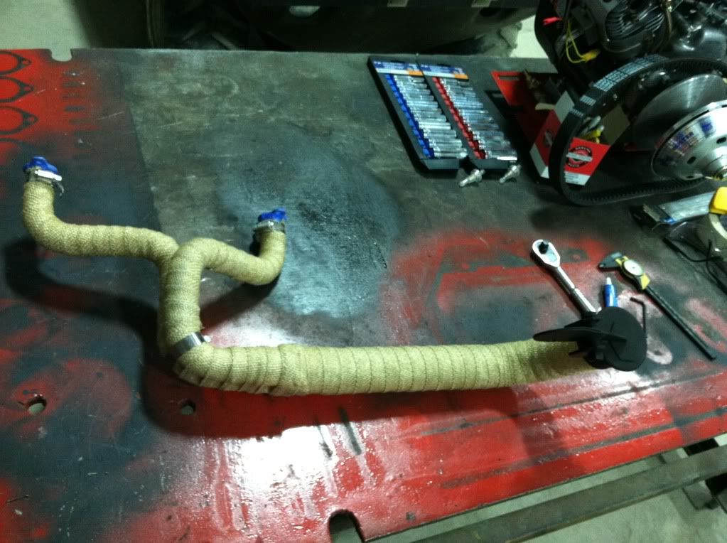

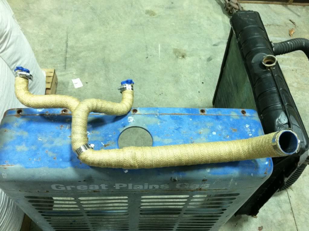

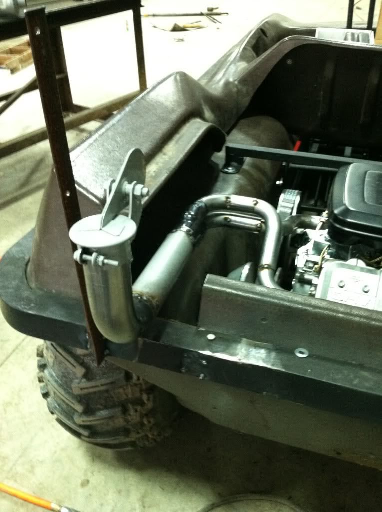

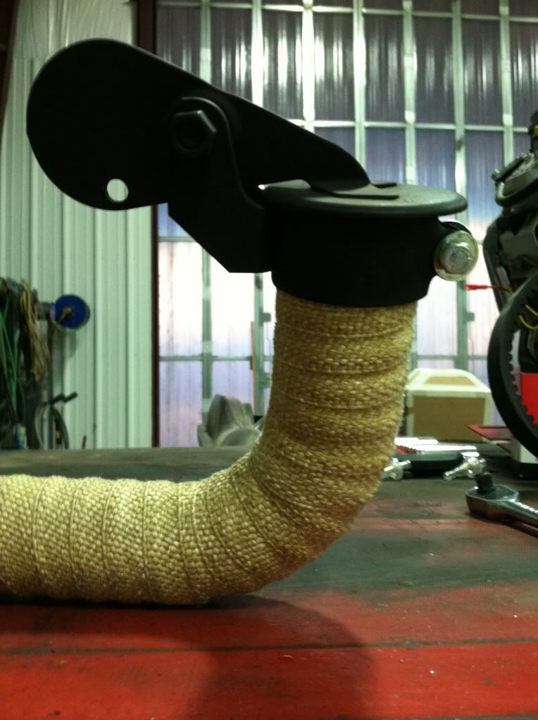

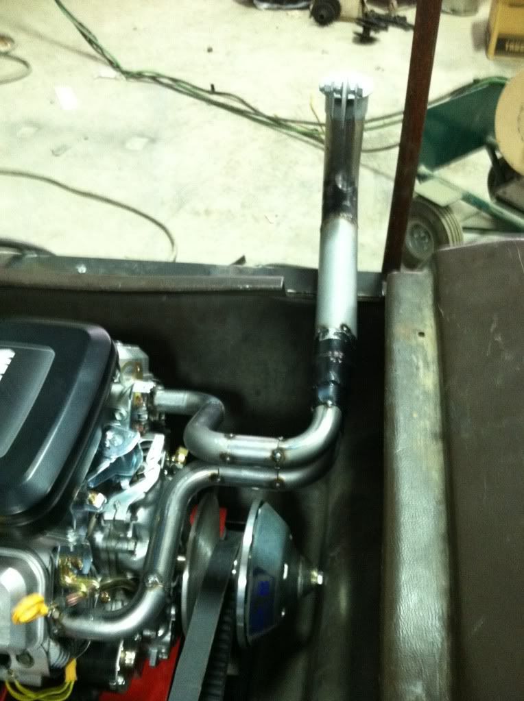

Well I decided that putting the big can muffler on the back was more trouble than it was worth. I cut it off and I'm now just going to go with a straight pipe. I havn't been able to make much more progress because I'm waiting on the machine shop to finish my other 2 axles. Then I'll put in the chains and engine and it'll start coming together again. In the mean time I've been working on making a box to mount on the dash for my gauges.
Pictures of the header:
Gotta have the raincap...

Good move on shortening the exhaust system. It looks GREAT! You'll be very happy with the header wrap as well......it really keeps the under the hood temperatures down. One suggestion that I'd recommend would putting an RLV silencer in the end of the pipe so there's a little back pressure. This way your jetting won't be that off and your valves won't be so prone to damage. I did dual RLV silencers, but one would work just as well for you I think. I got the standard 1 5/16" for my Hustler and it's loud and aggressive, but doesn't drive you crazy on trail rides. I'd say go for this one instead of the open/modified one. Here's a link:

I looked at the RLV link you posted, but if the biggest is 1 5/16", that won't work on my 2" pipe! If a straight pipe will cause backpressure issues, I may have to look for some other solution...1983 Hustler 945-HK 627cc Vanguard

60'x100' Oh that would take some time to fill up with toys! And I see you even have a pool table. It's a shop, rec room, place to chill, etc, etc. That's great! You might be able to actually take that RLV silencer and drop it right inside your 2" pipe and then weld it in........almost as if it were a muffler insert."Looks like you have a problem with your 4 wheeler........you're missin' two wheels there"

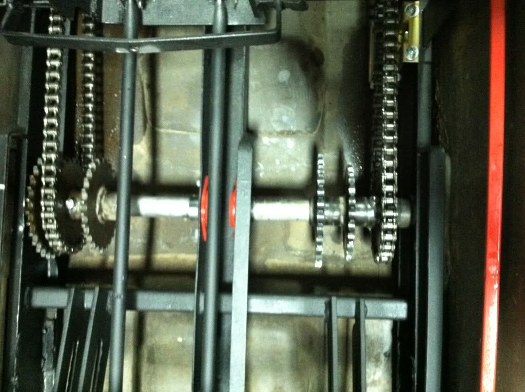

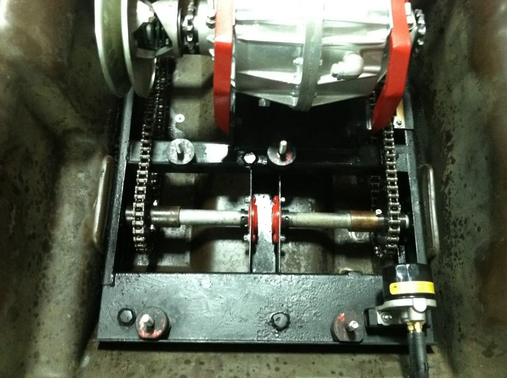

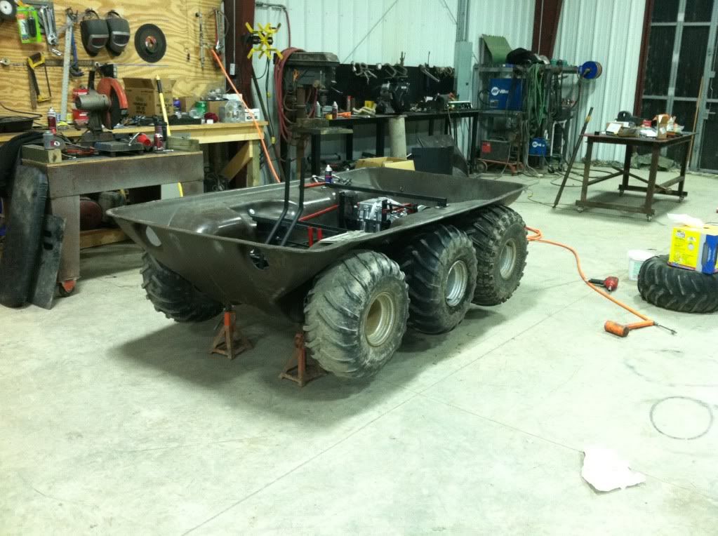

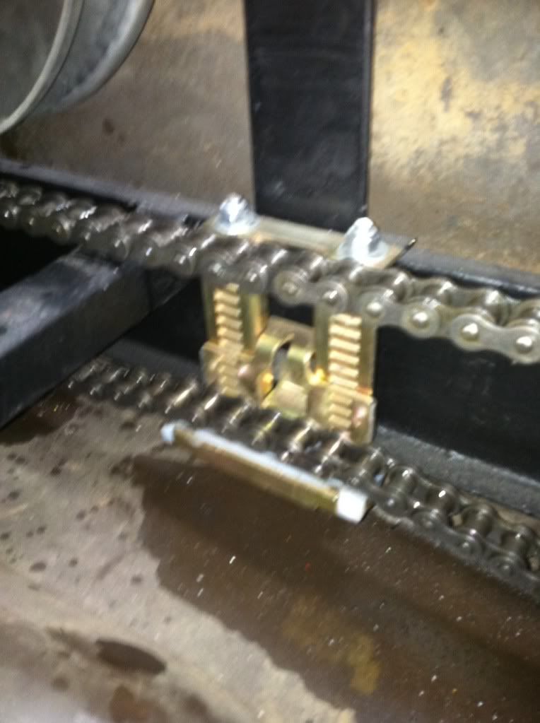

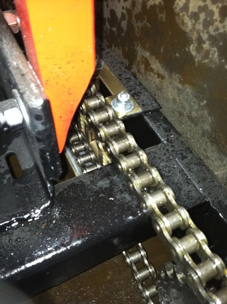

Made some progress today. All of the axles are in, and it's now on 5 wheels. The chains from the middle axles to the center axles are in and adjusted. The Max II chain adjusters are awesome! Hopefully tomorrow I can get the rest of the chain, and put it in, along with the engine, and then I can get started on the wiring.
