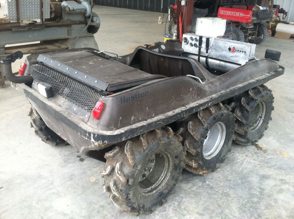

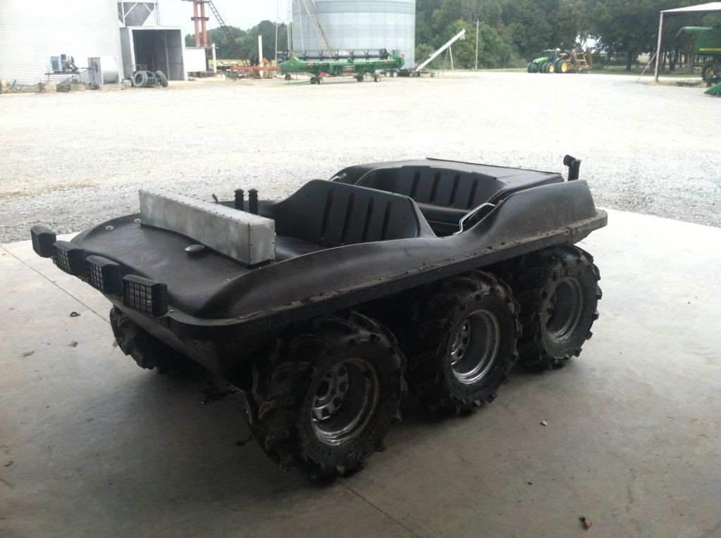

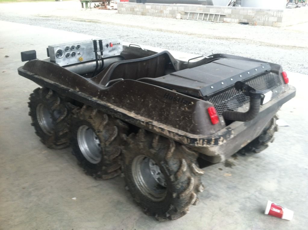

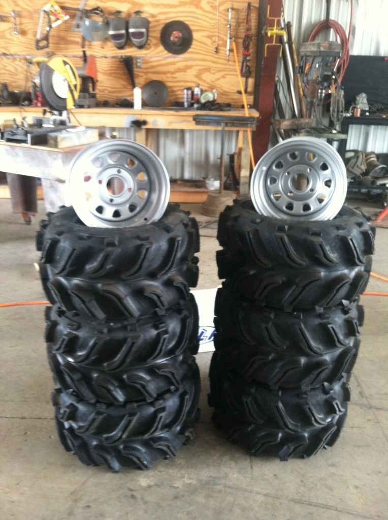

            After sitting in my garage all summer because I didn't have the money or time to finish, my Hustler is finally up and running and completed enough to call "finished"... I finally bit the bullet and bought a set of tires and wheels. I went with ITP Delta wheels and Interco Vampire TSL's (my favorite tire ) in 25x12x12. I got them all mounted up and installed this afternoon. They are awesome. I have them all set to 2.5 to 3 PSI, and there are no clearance issues.
            On another note, I need some help with tuing the Comet 94c clutch I have. It just has the stock spring and pucks, and the engagement is around 2500 RPM. At wide open (3600-4000 RPM) it will not close all the way on the belt, so I only get about 8-10 MPH. I need it to engage about 1500-1800 RPM and put a full squeeze on the belt at around 3600, so I assume I need more or heavier pucks. Does anyone know where I can get these or what for certain I need?
            Anyway, here's what you really want to see:
            Enjoy!
