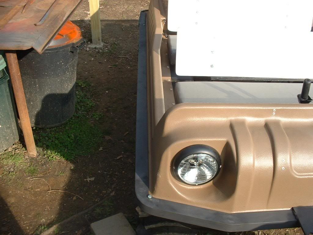

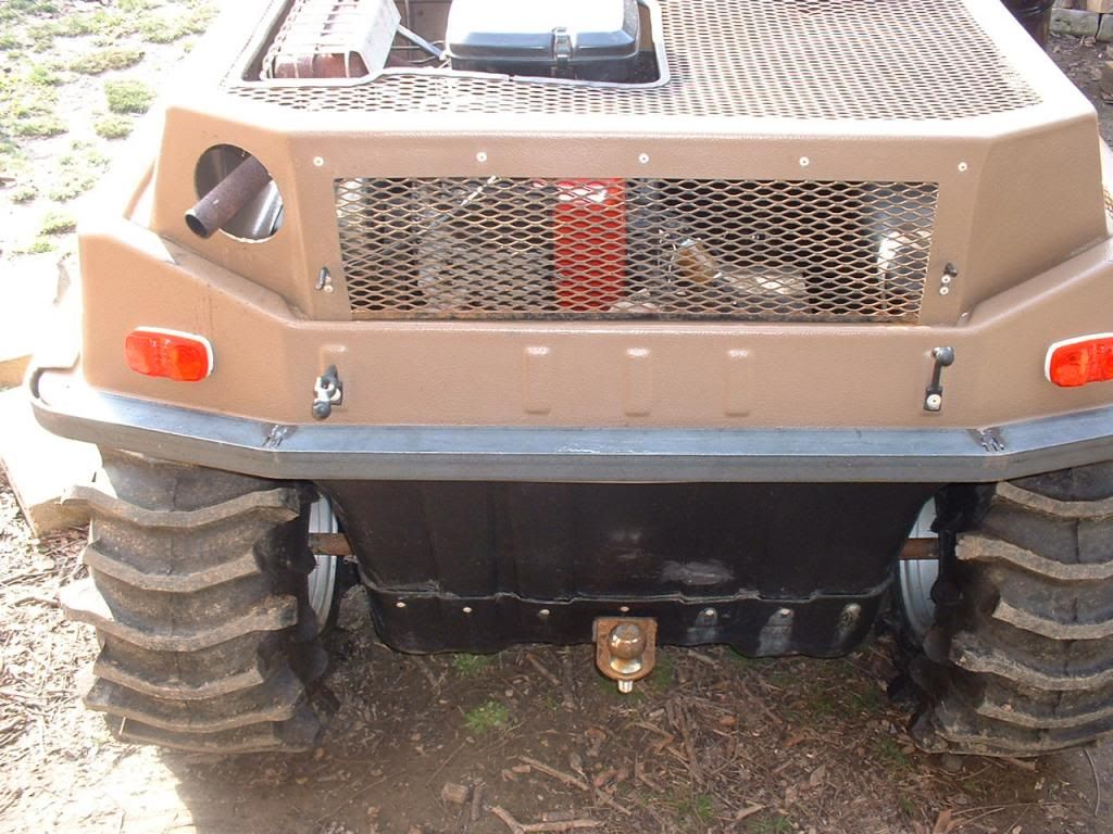

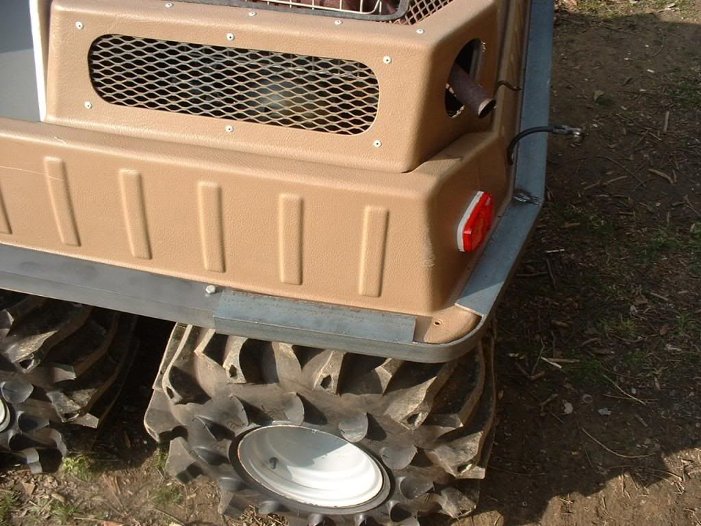

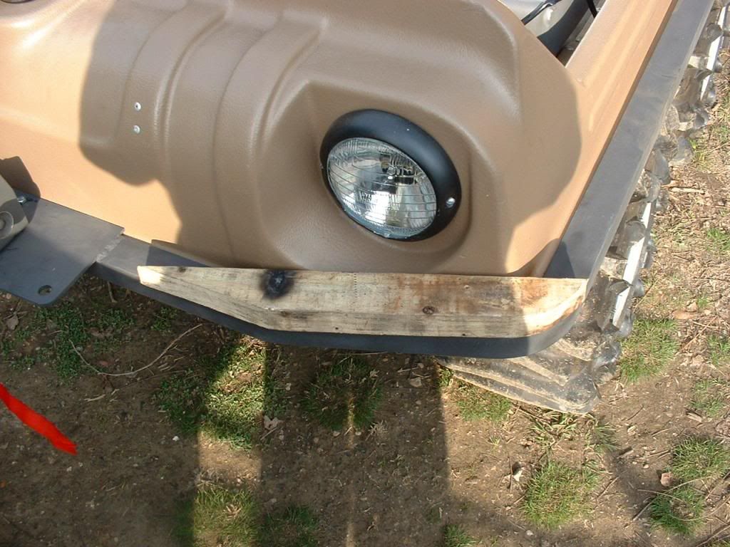

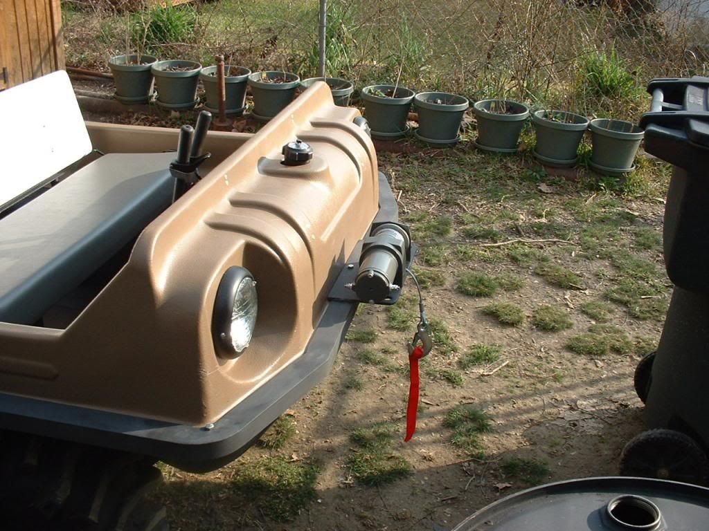

I know this has been covered before but thought I'd throw in my two cents worth. I searched through here and studied pictures and stuff and then I started the project. Got the front done with the winch plate, got the rear roughed in. The last picture shows the wood profile block I cut out to do the bending/forming/clamping/tack welding around to save wear and tear on the body tub. Freshly welded angle iron WILL melt the tub! I traced it off the tub and clamped it to the work table and bent around it. I was able to "pie" cut the small radius' but didn't have any luck on the corners so I wound up cutting out the entire corner so it would bend easier and pieced in some plate. I used 3/16" thick 1 1/2" x 2" angle. I need to finish weld the rear section and weld it to the front and drill all the body mount holes and prime and paint and wire up the winch and mount a larger battery. After I get this finished up I'll bend up a roll cage and make a removable rack over the engine. In case you're wondering abut the seat backs I got the wife to recover the bottoms and she hasn't finished the backs for me so I just bolted in the boards to use it for deer hunting.
