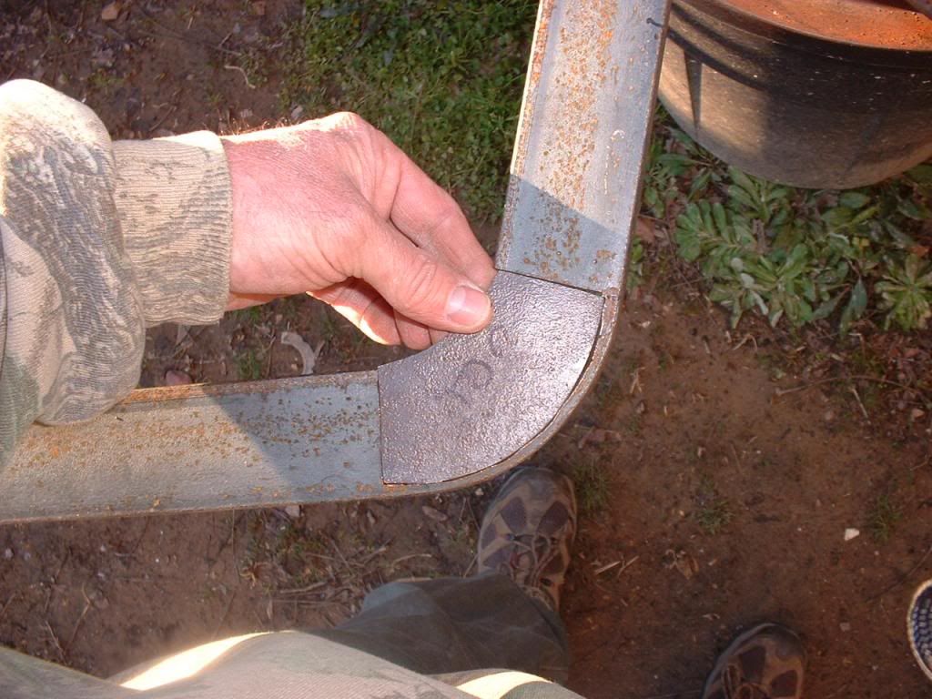

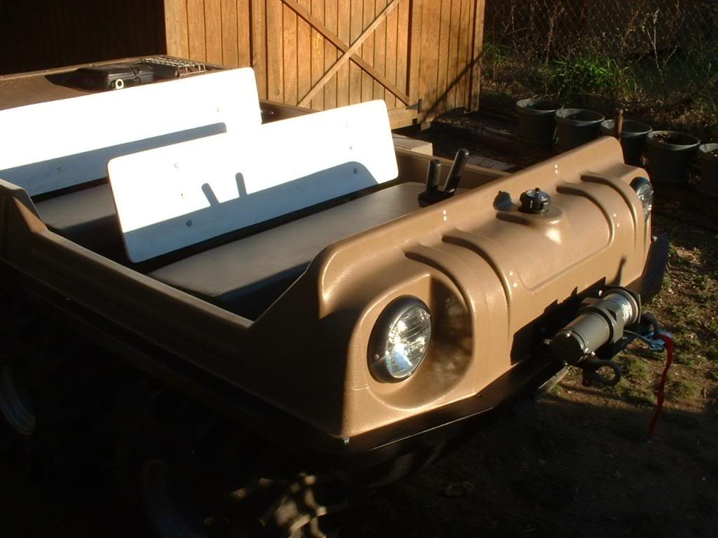

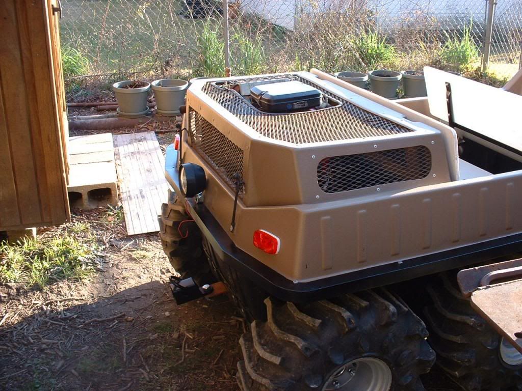

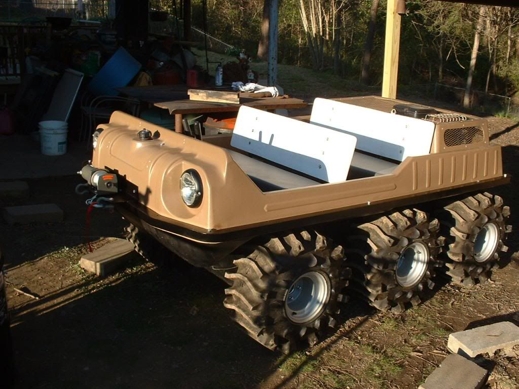

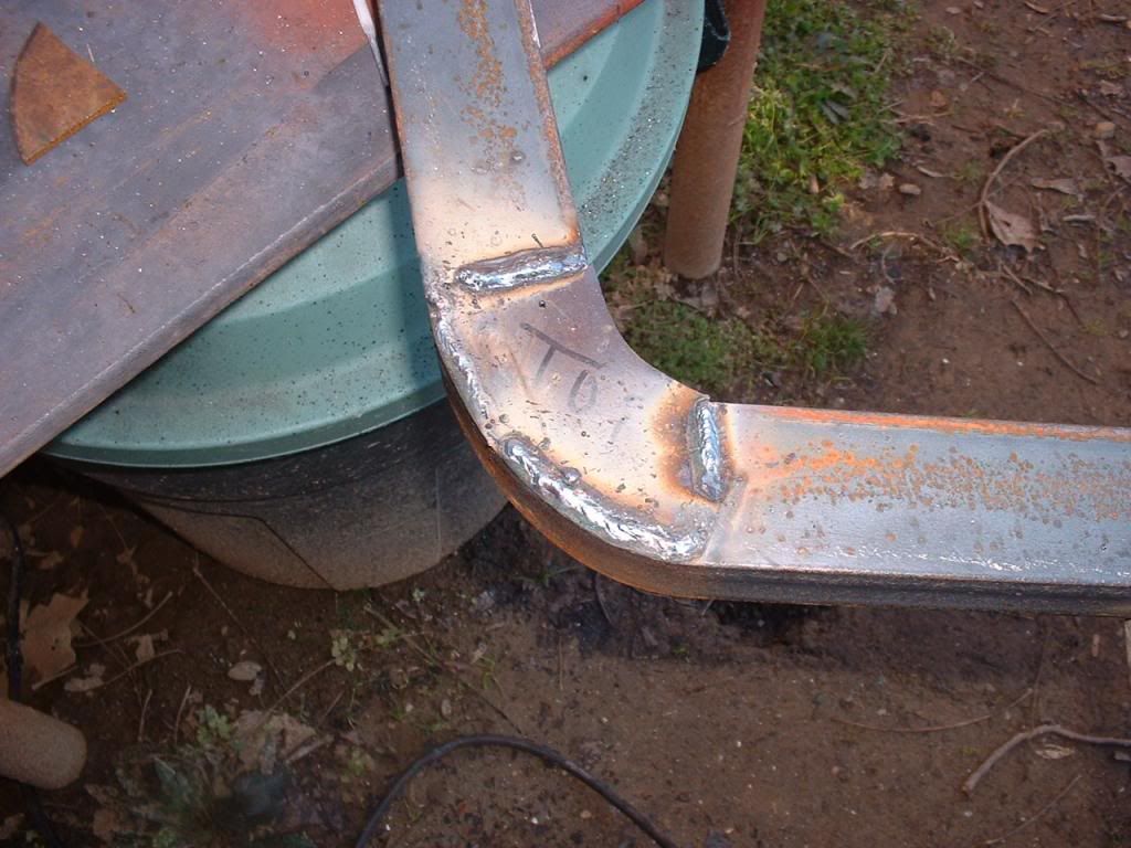

Well I worked on this thing yesterday afternoon most of today and I've got it pretty much finished up. I've got to pick up some more bolts tomorrow and wire up the winch and rear light I mounted and I'm going to put in a bigger battery but all in all the body band is finished! I took a couple of pictures showing how I did the corners and a couple of pictures of the finished deal. I also welded a plate on the rear of the winch plate and sandwiched the tub like the factory winch mount. I don't see any way it can give with the band wrapped around the body and the plate sandwiching the tub.
I'm pleased with how it turned out! Now to get some roll bar tubing and get started!
