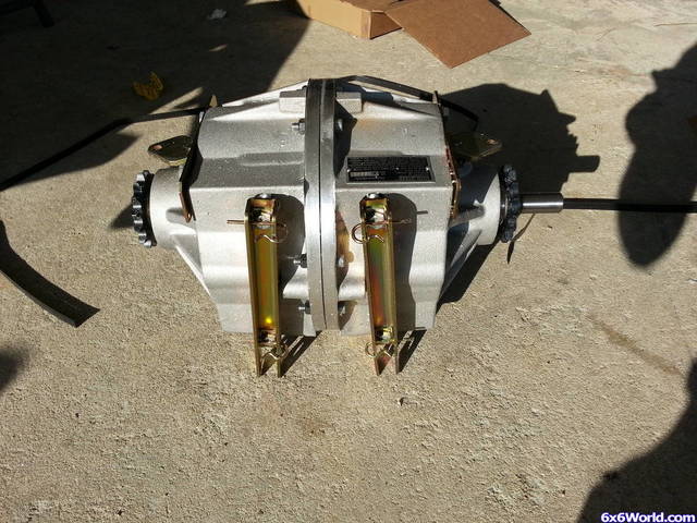

      The new t-20 transmission. I didnt think it would ever get here
      • #18
        I got the transmission installed with extra bracing.

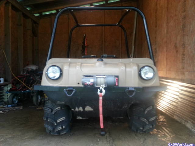

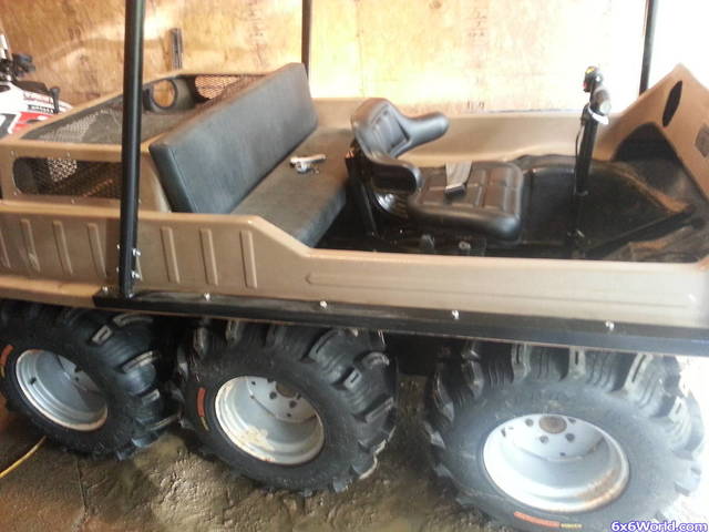

          finally got my new bearings in and sealed. Had to heat the tub to get my new tires on. 27x12x12 executioners.
          Winch installed...3500lb

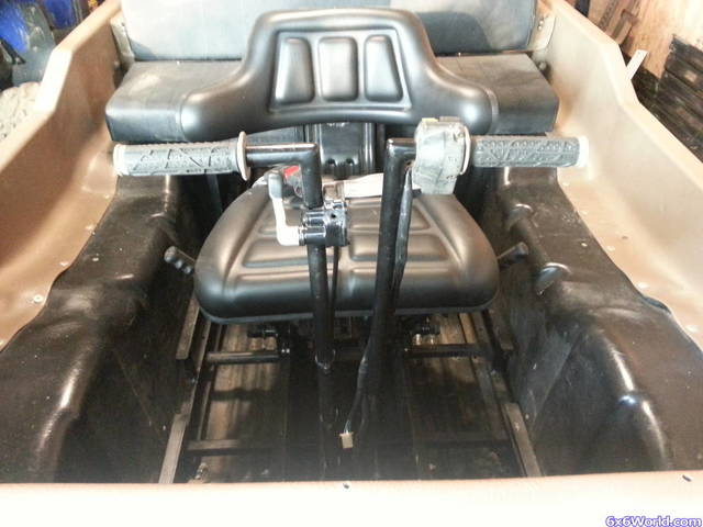

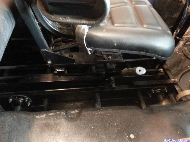

            Suspension seat installed with split shift on each side of seat.
            Handlebar set up. More comfort for me..Been riding bikes to long. New throttle cable.

              I'm ready to get this ride done....ready to ride.
                If the body settles any more you can add a lift bar. Then there is no need to heat the body for tire clearance.
                                Your Max IV looks like a fantastic mud machine. The tractor suspension seat is also a great addition too! I have these same tires on my Max IV now , with the Executioner tires facing forward for maximum traction. Since these tires hardly moved my Max IV in deep water, I installed two Goodyear Terra tires in the rear to see if this tire combination would help with my water speed. With this tire combo my Max IV will swim across a 30 foot pond in about 17 minutes. This is ok with me, because I hardly ever drive into water where my tires can't touch the bottom.
