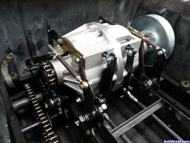

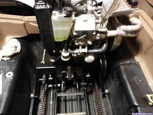

      15 hours of hard labor. Cut out and moved angle for battery box to hold a bigger battery. Welded in 1/4 inch angle for transmission to bolt to frame instead of having the slotted frame. My secondary clutch arrived today, thanks fed ex. Installed red spring in secondary.
      Removed those rattle trap U channels and made my own out of 1/4 inch angle.
      The controls feel much better now.

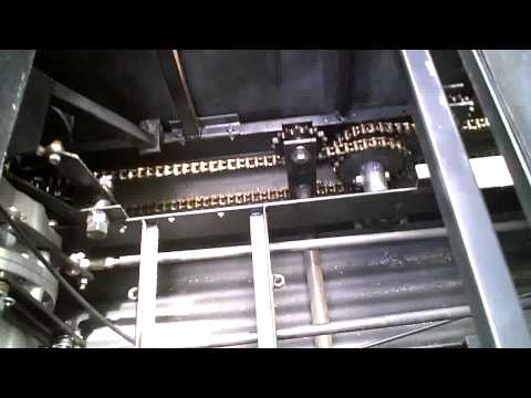

      Reinstalled t-20 and bracing around trans, Installed my chains. That was fun.

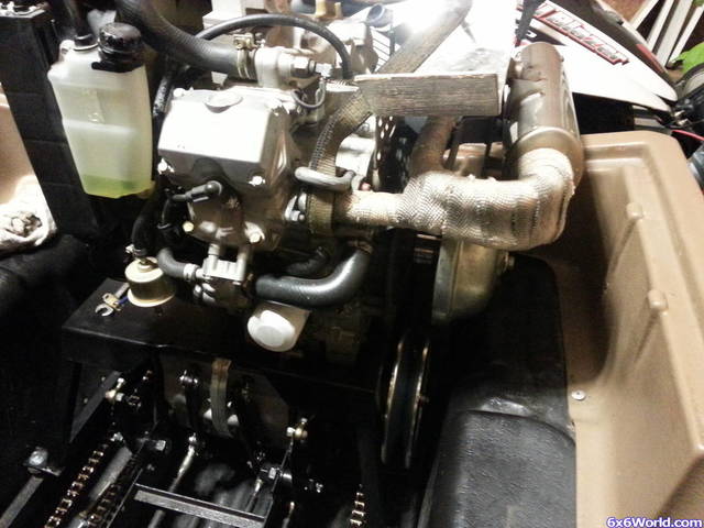

      Opened up the front of the engine stand so I could adjust t-20. welded in angle to strengthen stand. Installed and aligned 27hp kawasaki.

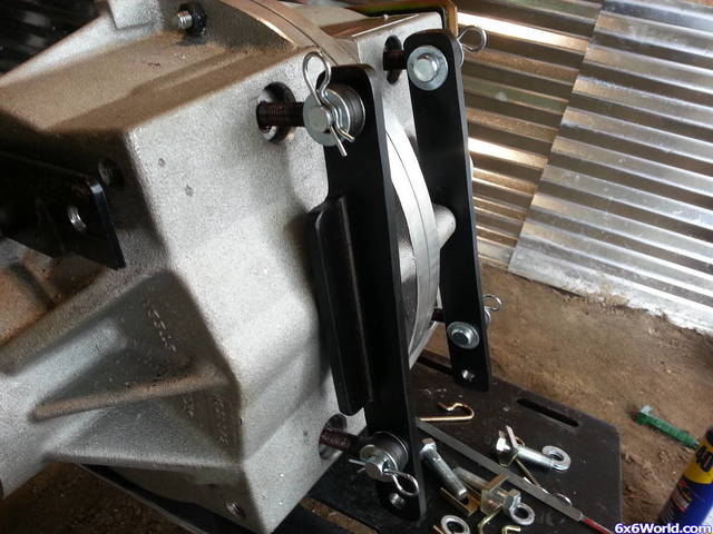

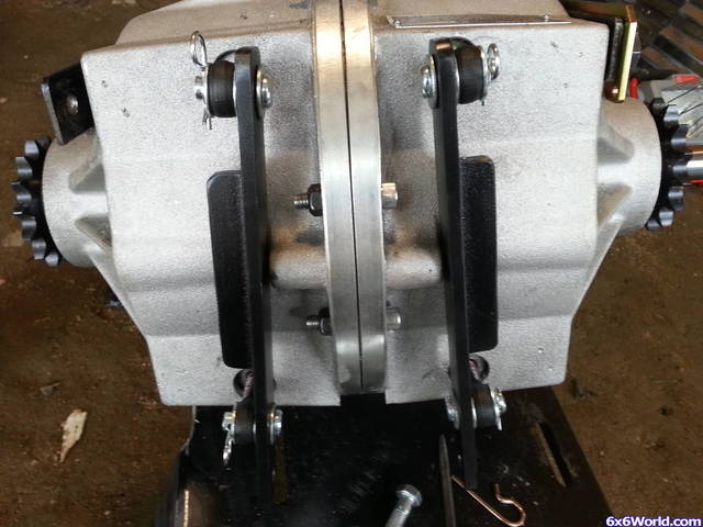

                  The next modification you should think about doing is the split shifter modification. No more rocking the tub back and forth trying to get each side of the T -20transmission gears lined up.

                    He did check out the pics of the t-20 mounted. Individual linkages coming off the diamond shifters running down down the chain channels
