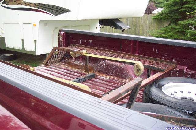

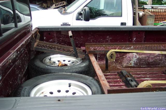

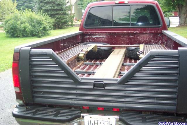

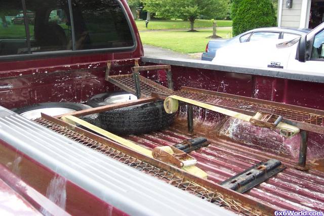

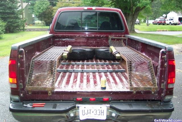

Sorry guys I lost this post for a while and my elbow wasn't and still really up to moving this thing, I did mount it yesterday and pick up a machine today. Here are the pics I promised oh so long ago, as i stated before the ramps have been modified over the years dor the tool bod and fuel tank ( not pictured ) but I layed the original piece in front of the right side ramp. It is built as a one piece unit now but was 2 originally. Going to eventually hook it into the 5th wheel rails.
Jim, I gotta say, that is a nice setup. I believe I could or (somebody good with a welder) could fab up something like that without too much cost. I really like it as you still have room under the machine to store stuff in the box."I'm NOT stuck, I'm just temporarily stopped"
