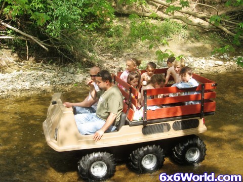

P.S> Sudden drop offs in creek depths are quite unsettling to newbies. Floating in general is quite un-nerving Heres a pic of the kids portion of the break in
