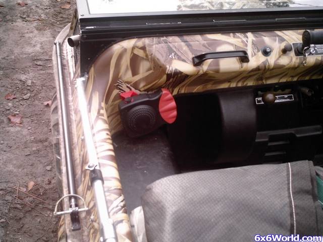

I have this!
It's a 12V ceramic heater from the local auto parts store. Only draws about 15 amps, and does a fair job for a defrost.

In my VW the engine is in the rear, so I put the oil cooler under the rear seat & vented into the floors. In my pic, right where the ceramic heater is, would be a good location for vents.
