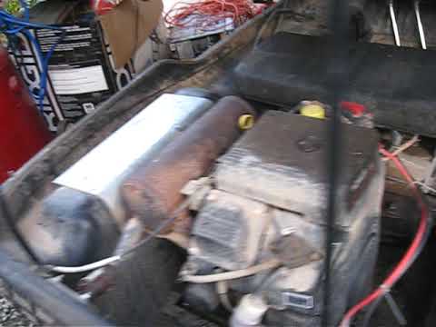

          Clanking noise from engine/clutch
          I got the chain guides in ( mostly, couldn't get one bolt in ) and now it makes a clanking noise even in neutral. Ideas?

            As for the sound, you really can't tell from the video but it has to either be the engine/exhaust or the clutches since that's all that was moving. From the video it sounded like an exhaust leak but it could be something as simple as a loose air cleaner cover. Take that cover off and see if it still makes it or if it is any louder.
                  I'll try taking the air cleaner cover off and see what changes, it does sound more like it's coming from the clutches. It seems to drive around just fine though.
