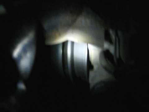

          I noticed the drive belt had 4-5 inches of slack, I didn't notice when I moved the engine to install the chain guides that it was adjustable. I tightened it up but the noise persists. Sounds like it's coming from the clutch and goes away under throttle.
          • #20
            Is there any chance you have anything rattling in your muffler?
            • #21
              You may have a broken spring in the clutch. Unfortunately the engine has to be loosened up to get at the clutch bell cover. You can possibly check for the clang by taking the spark plugs out of the engine and rolling the engine/clutch over by hand.
