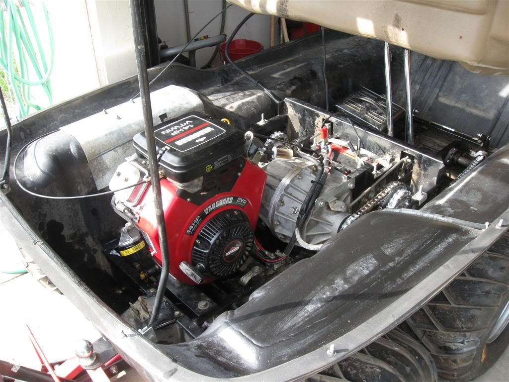

    I still have to change the tranny fluid and adjust the chains .. then were all set! I will post pictures tomorrow.. any advise on how to adjust the chain tensioners? I looks pretty cut and dry but I'm at a loss as to how they loosen up... I'm not so sure of the spring loaded Latterals as of of yet... Way differant from the Attex ones..
    First off, that's an amazing deal! Very nice! The first thing I would do is take the springs off of the laterals.......it makes driving so much better in my opinion. Now as far as the chain tensioners go, they're a poor design, and once they start letting go and not staying tight, they're pretty much done. They have very fine teeth that they click and ratchet into and once those teeth and/or the channels wear they're pretty much done for it. If they are misaligned with the chains, they will go bad very quickly, so make sure they're lined up perfectly. I think your best bet would be to either get some new ones, or maybe figure out a way to redesign them. But if you want to just get back on the trails, just order some up from RI and go (after you change the transmission fluid and check the machine over of course). Amphibious Six-Wheel Drive All-Terrain Vehicles: MaxATVs - Call 1-800-255-2511

      Just to add to Jp on the tensioners, you manually push them tight and they should stay there. To loosen you need to cock them sideways to release the teeth.
        It has no roll bar... How do they attach ? My buddy owns a muffler shop with metal bending skills so he could make one .. I see the factory one goes through the top of the tub...a couple things come to mind... how do you then raise the lid? How is the roll bar secured? Thanks Guys!!
          The roll bar is connected to the top and when it sits down it fits on some pins. You can remove the seat to access the pins to remove or install the clips. I made a picture to show the pins.

              The roll bar bolts behind the seat on the steel plate and the pins are for line up of the upper body and pin the the steel plate to the frame . The steel plate holds the seat belts and roll bar to the top .

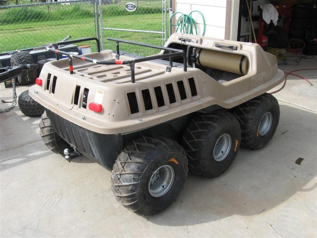

              max2 with 3000lb winch,split shifter, off road lights, and 50 amp alternator

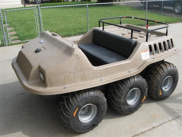

                Here it is.. I had the Zipper tires ($300) including the tires I'm in it $1750 .... considering what a used gas Heli goes for on ebay..(I even through in the flight Simulator and encouraged to him to do his homework) .. we were both like little kids at Christmas!.. I have some automotive seam sealer about the same body color to put in them 9000 holes.. I removed the springs.. MUCH better!!! Greased it all up... and we're rollin!
