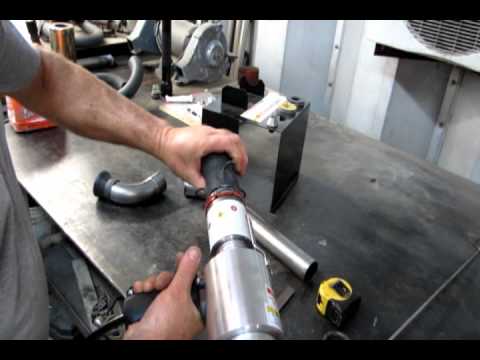

              • so ive gotten tired of that loud race car muffler on GOLIATH, im going to build a new one from an old redline revolt muffler and center pipe...im using a huth tubing expander to make it all fit together...THE SOUND QUALITY IS BAD. I PUT THE STUPID CAMERA IN FRONT OF MY SWAMP COOLER..sounds like the camera is going a hundread miles an hour..

                  • That is a cool tool.That sounds good and quiet.I have a few of those mufflers lying around if anyone needs one.
                    • i actually swedged out 3 parts so thats so far 375.00$ a swedge.....WOW
                      BUT TOOLS ARE COOL
                      • Very nice video Joe. I have just the hand/wrench type expander. You are the tool man!

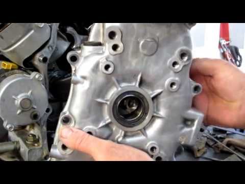

                              • well this last saturday i was up in phoenix and had a little trouble with GOLIATH..
                                not a good sign when its on the trailer backwards..42 HP AL HODGE MOTOR IS HISTORY..connecting rod failure
