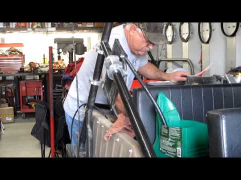

        • COOL T-20
          the COOL T-20 has been given its first drain and flush, now what to do with the rest of my day..

              • thanks whipper, i didn't get any readings forgot to bring my temp gun..but it was definitely working..
                now for an upgrade to the upgrade, i'll show that later..
                • wfo this is so awesome, please tell me more about pump and check valve.
                  Love the music in the video, good choice!
                  This would make changing oil in the Hagen a real simple task as well. I'm doing this now for sure! Now to get the pump/valve ROFL.
