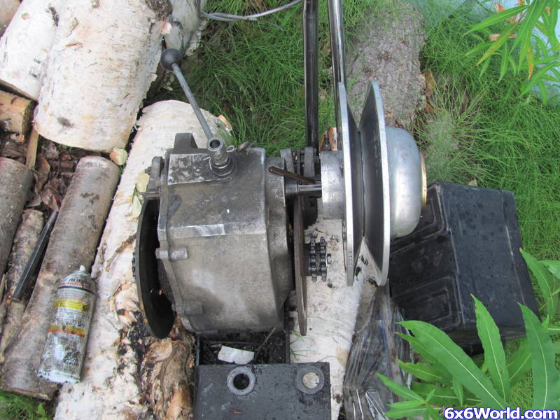

      I am looking for some guideance on clutch setup. If any of the members that have gone through it could give some input it would be appreciated.
      First I need a secondary clutch that will switch the offset on the belt.
      (thebuggyman1 photo of stock secondary)
      To something like one of these (thebuggyman1 and spookum photos)
      This needs to be done to move the belt away from the tub on the MAX so I have room for the primary clutch.
      spookum had mentioned that the Polaris Clutch had a wider ratio than the stock argo, I liked that.
      Would anyone know what Polaris would fit a T20 7/8" (.875) input. I asked about one on ebay like spookum's and they said it was a 1" shaft. I would like to start with a cheap used secondary so I can get started fabricating motor mounts.

        I'm not sure how much room you need with that motor but does it help if you flip your clutches around and just run them backwards. That should allow you to run the belt closer to the T20 which should allow you to slide the motor over and gain a little more room for the primary clutch. Also, depending on how much more room you need and where the primary will hit the tub, you can just remold the tub. I did that to fit the engine down in my Max IV. Whipper did the same thing with Goliath I believe.

              The Polaris clutches are all 1" diameter shaft as JBF shows he used a sleeve to mount it to the t-20. I'm not sure on the outer diameter of all the polaris clutches but the one I bought and can't use is over 10" so there would be a clearance issue with a Max frame unless you mounted the T-20 higher. Also flipping the clutches around would require the secondary to use the other ramp in the helix. Also you might need a reverse wound spring too. I'm dealing with the same issue with my max and dropping the engine to the frame. I think the best option is to use te invance secondary like Buggyman did. If you find a different solution let me know as I'm in the same boat.

                I think if I could flip one it would line up nice, but then when it shifted to high , one clutch would try to move the belt right and the other would try to shift to the left. If I did both clutches, I think the engine would need to move too far right instead of too far left.

                Good info, I was wondering about a sleeve. The ones I was looking at were split and the keyway key went right through it. But I didnt know what I would do about the shoulder it needs to butt against.
                Mike
                This is going to be Mid Engine so the T20 is going to be far from its original position. Raising it up a little to clear may not be an issue for me.
