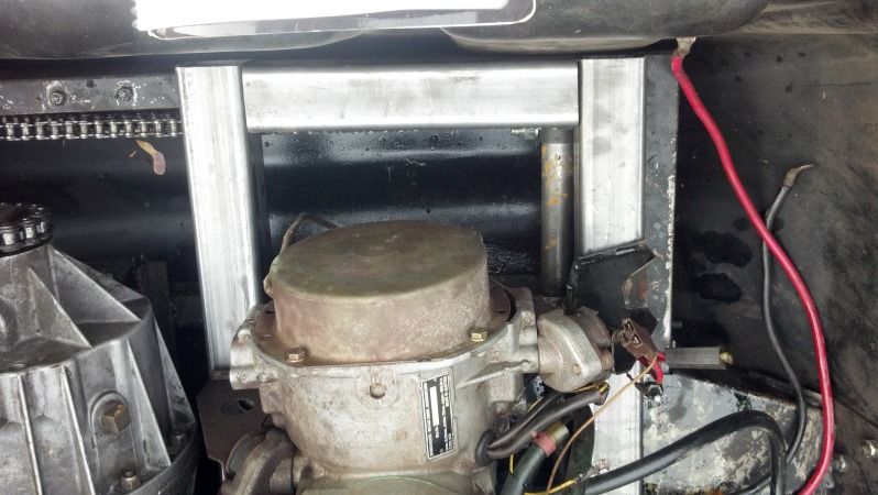

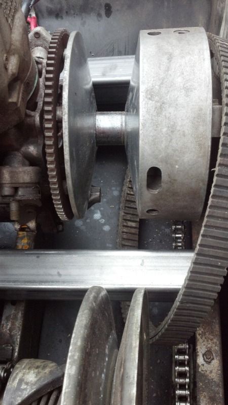

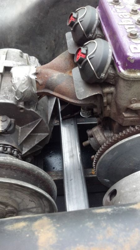

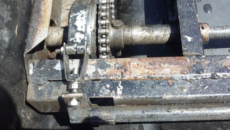

                            well its official. the frame is totaled. cracks everywhere, the inner rails are rotated about 15 degrees and bowed out. the outter rails are in the shape of a banana. nothing is salvageable, not even the trans mounts.
                            im really kicking myself in the ass with this project. i have no choice but to build my own frame or locate another. i honestly dont know how this machine moved before i got it. heres some max ii trivia
                            the max ii only has 6 bearings, 5 were bad, 1 was new, and one was installed backwards???
                            a 340cc motor was mounted to the inner frame rails with 4 1/8 botls, the trans is held in with 4 bolts, the max contained more that 12 nuts and bolts inside the hull that had rattled out out have been mia for sometime.

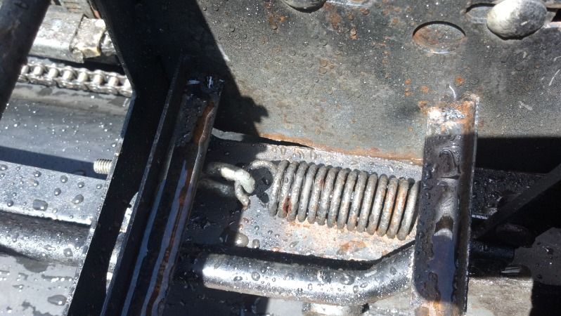

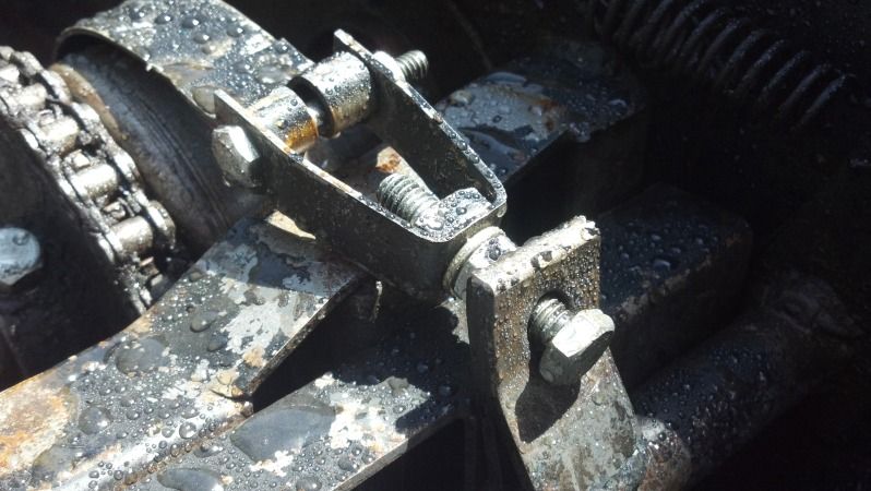

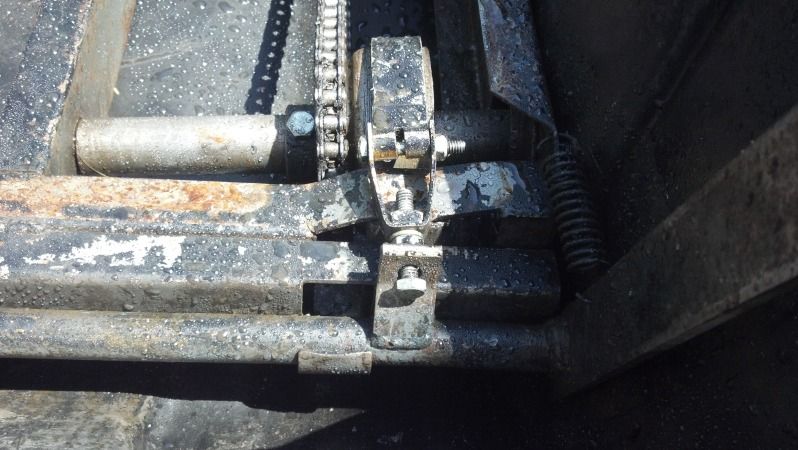

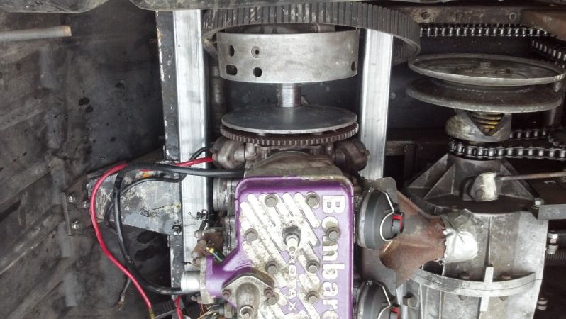

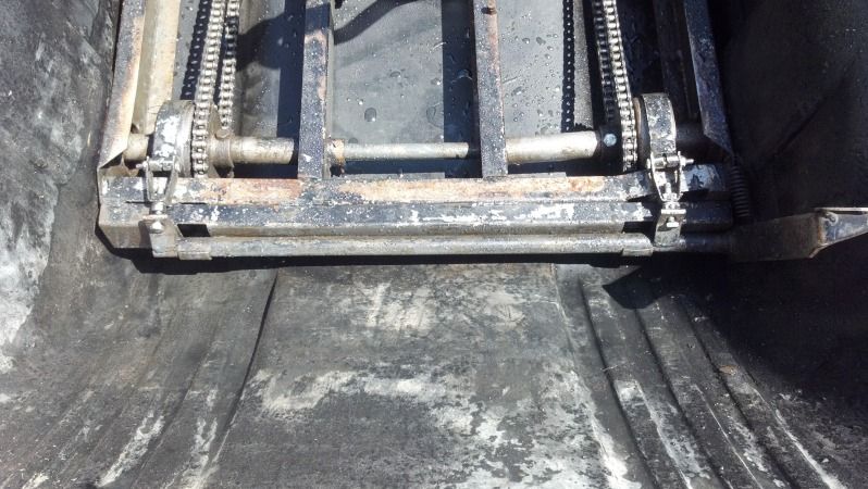

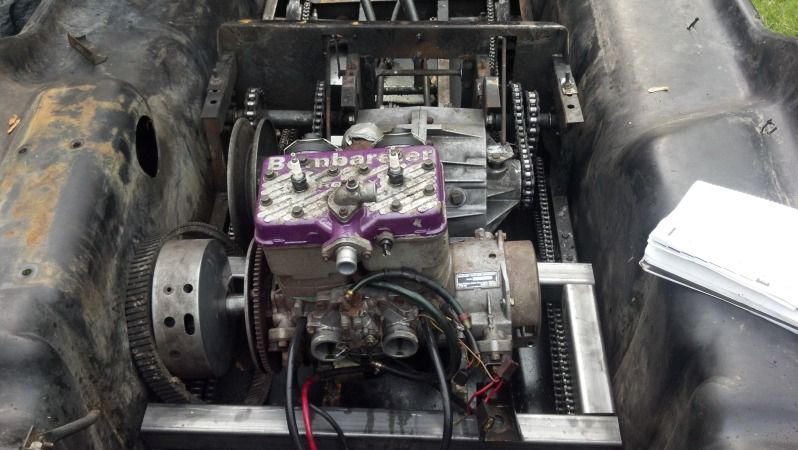

                            here are some photos before the bad news.
                            kinda ****ty pics but hey its something to look at
