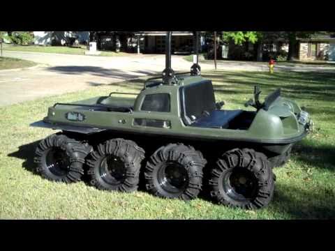

                    Thanks for bringing this idea to my attention. Thats what I,ll do. My neighbor loaned me a drill bit that is the same size as the holes in the five inch wheel extention that I took off.
                      I stood up an ASX tire in the mounted postion right behind a good year rawhide tire that was mounted to the right rear axle on my Mudd-Ox , and the wider 26 " inch ASX tire makes the 25 " inch rawhide tire really look small by comparison. The ASX tires will be better for most off road conditions, but if you,re a serious mudder, Tim,s swimming tracks on a Mudd-Ox are awesome!
                        This is what my Mudd-Ox looks like with the 5 " inch axle extensions on it. Since the tracks on my Mudd-Ox are only 14" inches wide, Matt is going to make me some 2" inch axle spacers to bring my tracks closer to the tub. This will be much better for the kind of riding that I like to do.
                          The Vampires look mean on there.
                            Now lets put that machine in the Mud. Cool look with the new rubber!
                              Dave, you must have been busy, to do all the runnin' around and still get the Ox cleaned up, and the asx's on there. It's clean and bad lookin'. Someone needs to do decals for the front of the Ox.. those recessed headlights have mean looking eyebrows..
                              nice quality on the HD flip cam, too
