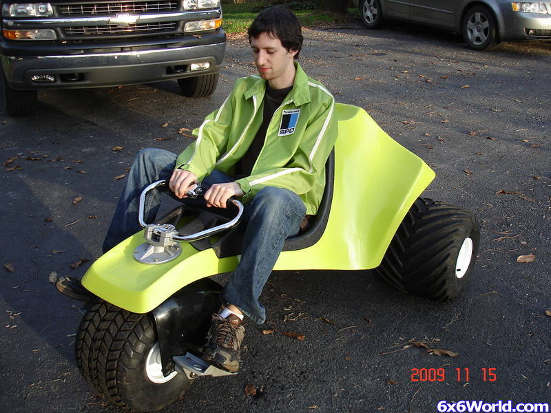

                  Progress continues on the Tricart. It's mostly together now but I still need to work on a few details. Thanks to new member teeksoffroad, I have a handle on a few of the missing items, including seat cushion. I need to do a final buff on the paint before I install the decals, still working on a brake cable. I've had the engine running in the unit, but belt is dragging slightly on the engine shaft and spinning the jackshaft. I can stop jackhaft from turning with my hand, but not sure if I should be looking for a slighly longer belt or not. I don't want this thing taking off across my yard when I hook up the chain.
                  I added some photos to my Tricart album. http://www.6x6world.com/gallery/showgallery.php?cat=706
                  including this one of wildboy modeling a vintage SPD jacket. (He wasn't crazy about me taking this photo.)

                    How can wildboy not be smiling while wearing an SPD jacket sitting on a brand new Tricart?
                    Great job by the way!
                    • #40
                      Believe it or not, there's a smile under there. He's desperately wanting to take this thing for a spin. He just doesn't understand my enthusiasm for the vintage jacket thing... neither does Mrs. wildman. Exactly like comments on member Mario's magazine photo... http://www.6x6world.com/gallery/showphoto.php?photo=274

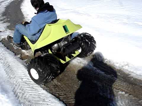

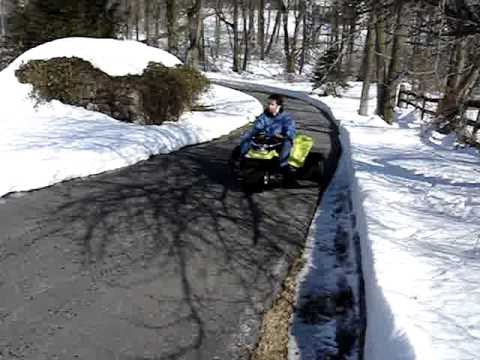

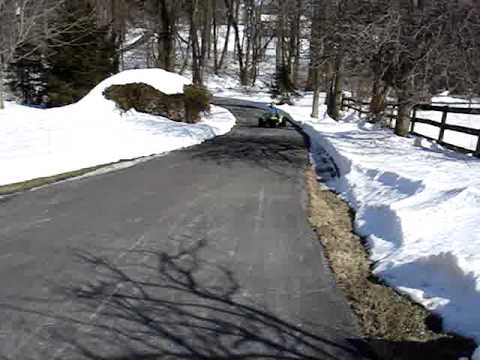

                            Ok, it's been a long time coming but the Tricart moves and STOPS now. This trike has been essentially complete since November, but I got hung up with the brake cable. I tried a couple of off-shelf substitutes, but ended up springing for a full custom-made cable ($46 + shipping). I found a great source if somebody needs a special cable. I'm still waiting for my custom-made seat cushion which should be the finishing touch. I understand now that the seat cushion is a vital part of the suspension and vibration isolation.
                            Enjoy these videos of wildboy and the maiden runs.
