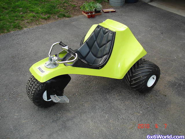

As soon as I mention my frustration waiting for the seat cover on another thread, I get the call saying it's done. It came out pretty nice, but not special enough to justify the 4 month wait.

I know what you mean last time i took something to an upholstery shop i ended up doing it myself. And all it was i had a 20ft tarp i wanted a 24 inch hole in the center and stitched up. I see you got your seat cushion. Man you done an outstanding job on the restoration.Last edited by MarshallEpp; 05-02-2010, 01:40 PM.
Hey Joe. I wish I could say that it runs as good as it looks, but no spark right now.
As soon as I can get that old JLO purring again (well maybe purring is too optimistic for a 2 stroke), I'll be glad to get some more video up. I may be down to needing to pull the flywheel, but I don't have one of those nifty pullers. Anyone out there with a JLO flywheel puller for sale?... rent?... trade?... borrow?... anything?
