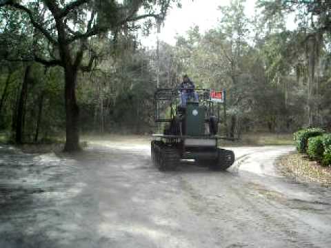

What you have just described is the reason that all modern bulldozers, excavators, and most other tracked equipment use hydraulic drive systems. The clutch/brake system is very difficult to operate unless it has been well designed like the t-20. I already have everything needed to steer in the axle. What I'm really worried about is wether or not having the engine in front like an argo will make it too front heavy, and how to keep the tracks in line with the bogies. Does anyone know the percentage of weight of the argo is in the front? And how well do the argos float with their engines in the front.
