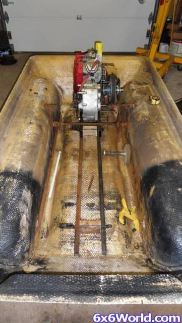

                These projects Like Godzilla take time. In my case my toy budget got depleted due to our well pump dying. So I had to rethink how I was going to build it. The current design will use allot of my salvaged Scrambler parts. The old jackshaft in the photo is just for reference and will not be used. I will upgrade the chains to 50 pitch. I hope to have it ready for the summer though.[IMG][/IMG]
                Backbone frame rails located for original Scrambler axles and bearings.

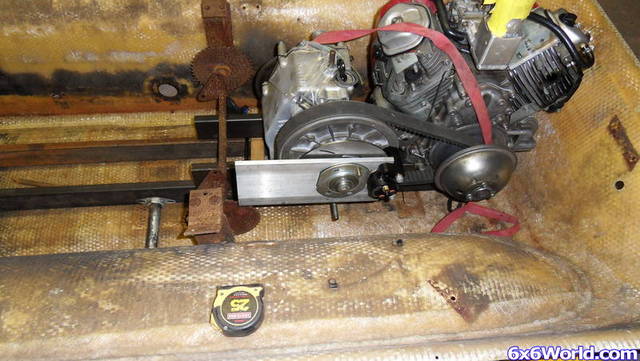

                [IMG][/IMG]
                Plenty of room to service engine and trans and chains.

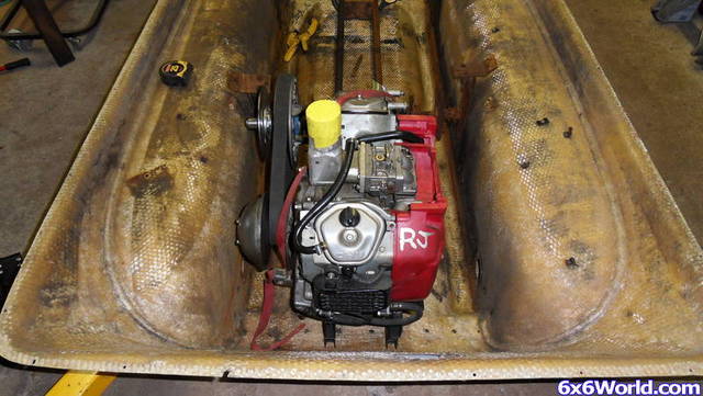

                [IMG][/IMG]
                Disc brake to be operated from existing foot brake. Torque arm (aluminium plate)to be attached to jack shaft frame.
