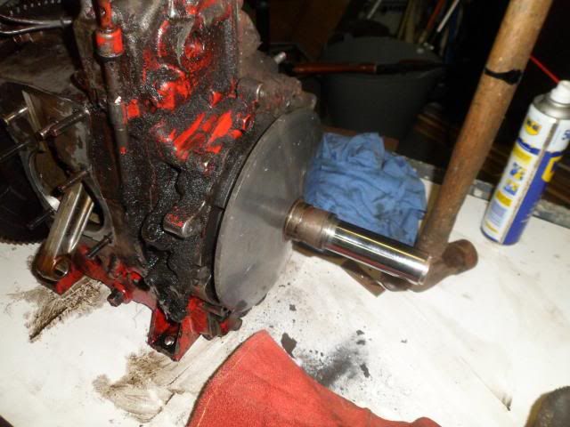

The rest of the clutch is already off, it is just that one plate that is still not budging, also the engine at the moment is literally just the block and the
internals, cylinders etc are all off. also its a power bloc clutch so it was held on by a bolt through the inside of the crank, will new engines have this or will it be threaded on the outside?
