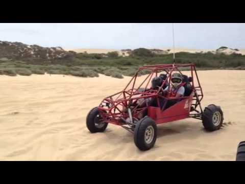

                  Been awhile since I've been back on the buggy, but i have done some mods that have seemed to help out with the RPMs only topping out at 4500.
                  First off, I installed the Al Hodges Cam and it feels really good. Went out to Pismo Dunes and it had no problems getting around. Only problem I had was it would seldomly bog down when I would hit a big whoop and buck the rear. Im thinking it was the Carb Float. I'll lower the float a bit and see if that helps.
                  I also took the Salsbury 1190 Primary clutch to QDS to see what they could do for it. I had the 1800 RPM springs and Roy set me up with a 2300 springs.
                  The new springs made a good difference on the take off Torque, I like it alot better but it still maxed out at WOT at 4600 rpm's.
                  I had a hard time finding out what vehicle my Secondary Clutch was from and the closest I found was the Polaris RZR 800, except mine has .875 shaft with Keyway. Polaris RZR has a tapered splined shaft. I couldn't find any vehicles that use a .875 straight shaft with keyway. So mine must have been Bored and Broached.
                  I couldn't find a matching colored spring on any of the charts either! So I took the spring to get a compression test at a local Valve shop.
                  It measured 80/120 and when I did the marker test on the Sheaves, it was maxing out the belt at 3500 RPMs. Which makes sense being that the stock governed engine was 3600 RPM's.
                  So I went on the EPI Springs sight and ordered a new Secondary spring for a RZR 800, Light Green 125/220.
                  Now it's starting to get up in the RPM's. Maxing out now at about 5000.
                  This is my first CVT tuning rig so Im not too familiar on how it should feel or what the Tach should be reading during quick acceleration. It'll jump up to about 4000rpm's until the speed catches up and then it will work its way up to 5000 rpms, which is right about where I run out of runway.
                  Watching Nubs Drag racing video, it looks like thats common for a CVT engine to jump up in RPM's until the speed catches up then it continues to rise. But I could be wrong.
                  I shot a Bumpy video showing the Tach.

                    Clip from Pismo, Before new Clutch springs
