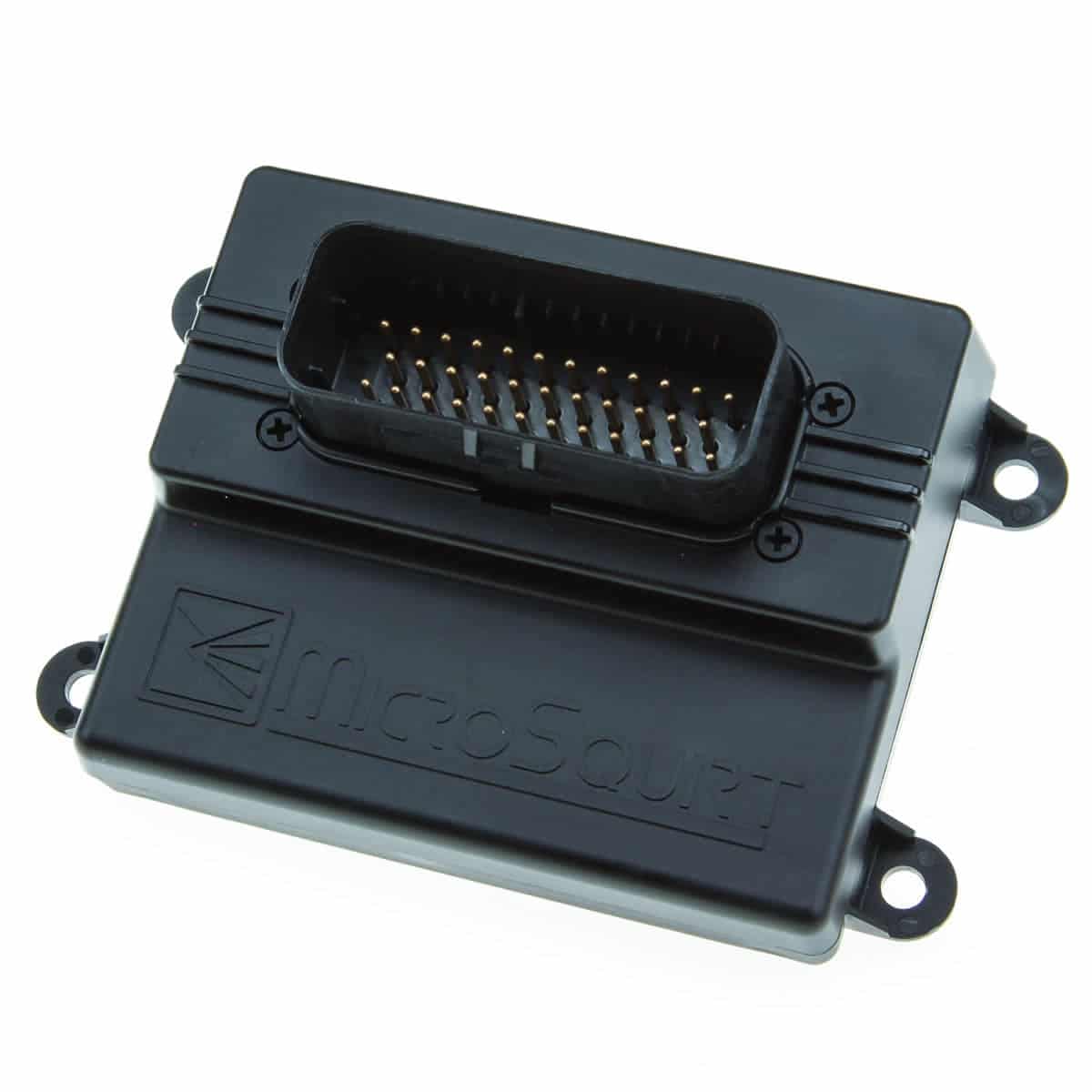

      The MicroSquirt ECU Version 3.0 Programmable ECU for motorcycle, snowmobile, personal watercraft, and other engines up to 8cyl!

                You need an engine management system- absent activating the injectors it is responsible for telling the coil when to make spark, and this also involves spark and therefor timing advance. I believe you could jerry rig something, but there is no way it will ever run at a satisfactory level. If you want to, you could adapt a "micro squirt" box and shoe horn in the wiring, but it may or may not work. I learned ALOT from the guys at Geo Metro Forum.

                      I'm going to mount a standard assembled Megasquirt II 3.0 board under the dash of my Max sometime after I do the re-wire to start watching RPM, mass air flow, etc signals so when I eventually put an injector to it I'll have good data. Back on point, the Microsquirt box is effectively a better sealed smaller version of the Megasquirt II. You have to have some wiring aptitude, but I've stuck these things in a '67 Thunderbird, '69 Firebird and a '77 Skylark, so I'm very comfortable wiring and plumbing these type of things in, but it's a steep learning curve for the first one. There is something nice about going with the minimalist approach though too! All depends on your goals and patience.
                        I can't wait to see it! Those guys on that geo metro forum, from what I understand, love the mega and micro squirt boxes- they get nutso mpg out of the geo!
