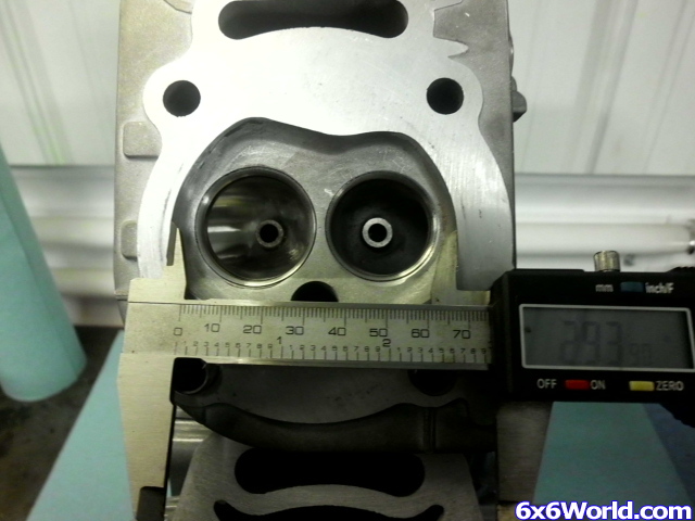

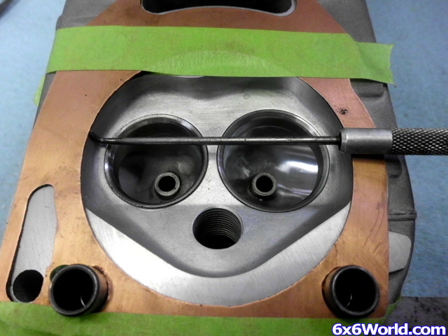

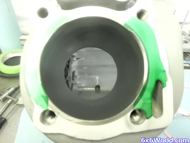

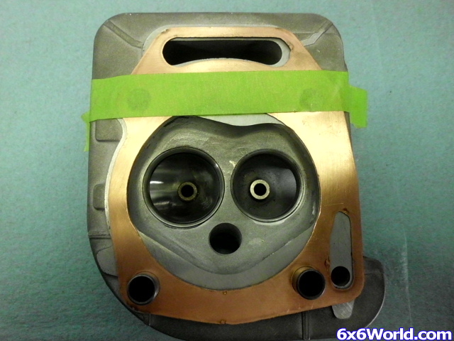

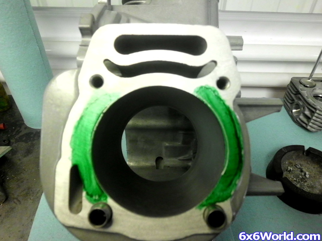

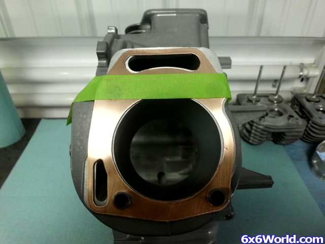

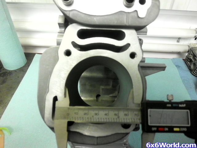

Got the head gaskets today, the chambers on the 23hp heads are about .095 wider than the .020 over 18hp bore.
scribed the chamber foot print on the gasket and ground it to match, then transferred that to the block and blended the top of the cylinder to match. guys did this years a
go on big block GM's etc for valve clearance. Sorry for crappy pictures
