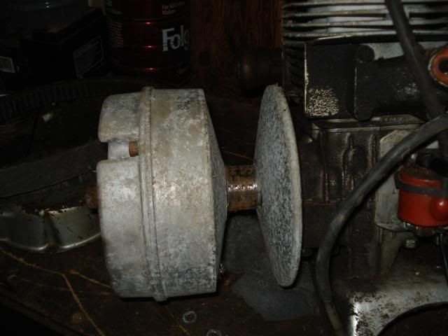

                      Can you post a pic of your clutch?

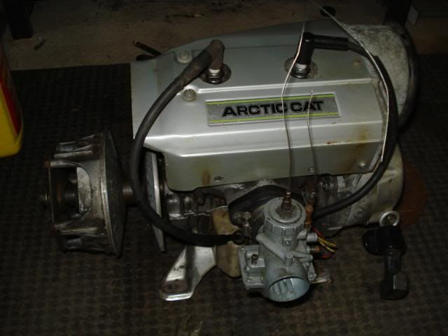

                        Here is the engine I'm looking to use
                        This is the clutch

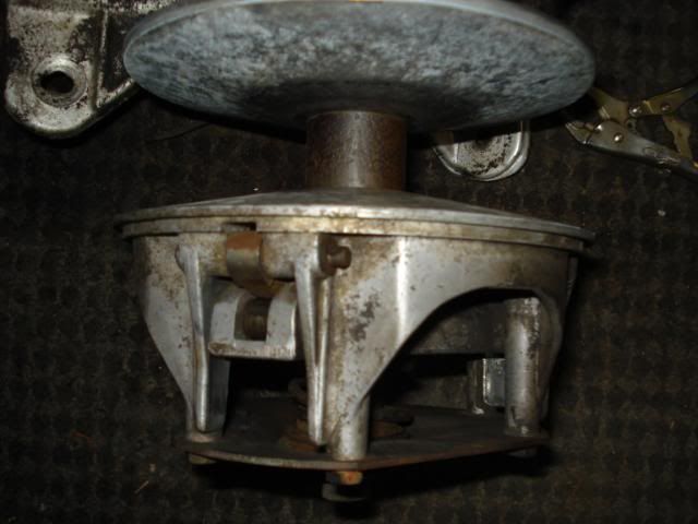

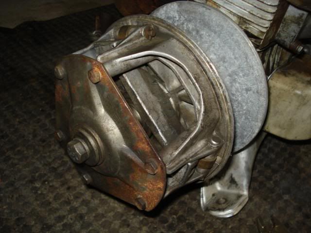

                        Here is another clutch on the parts engine

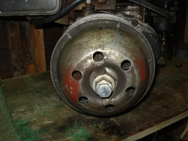

                        And this is the clutch on the 10hp Briggs that was in it

                          If you use the arctic cat engine offset the fixed face of the primary 1/4 inch to the right of the secondary fixed face when the secondary is pushed to the left (away from the t20) viewing it from the rear as in your pic.
                          When the primary closes it will open the secondary and the secondary fixed face will move towards the trans and be inline at higher rpm.
                          Thats how i would set it ...the secondary is self aligning.

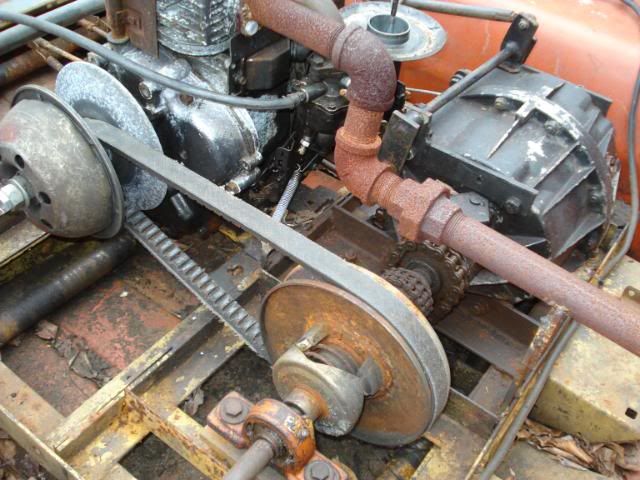

                            Big Sal:
                            Before you go any farther....measure the belt width of the original belt from the trail boss. If QDS was correct and you were set up for a comet 40 series clutch, the belt should measure approx 7/8" wide. This belt width is not going to work well with the artic cat primary, that probably uses a 1 3/16 or 1 1/4" wide belt.
                            Replacing the secondary is probably cheaper than replacing the primary...if you could even find a comet 40 series for a 30mm tapered shaft. Not to mention the smaller diameter of the 40 series will have less change in drive ratio than the standard clucthes we use.
                              Why not use the arctic cat belt......Is it 1 3/8" ?
                              You wont have as much top end speed because of the secondary size but who knows the gear ratio after the t20 ?
                              The ac engine will run best around 5 to 6000 rpm.
                              I would try it and if its too slow then look at using the ac secondary and relocating the t20.
