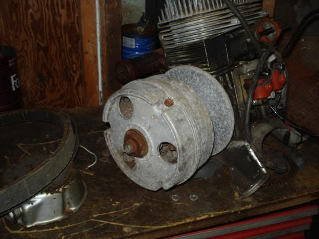

This one....
or this one....
I just don't know what they are....anybody have any educated guesses???A person who says "anything is possible" obviously has never tried to staple jello to a tree....
The first one looks like a hex clutch and is the one i would use.
Is the part where the belt rides hexagonal?
The second looks like a comet 94c or salbury 770 but its hard to tell.
When you get them off look for id on the backside.Last edited by Bazooo guy; 04-21-2012, 12:12 PM.
The first one I got apart...it has rollers in it...but they ain't rollin....lol I gotta pull the rest of the shaft off....it's splined on the inside...I found a repair/service PDF file on the clutch...so that will help a bit...lolLast edited by Big Sal; 04-21-2012, 10:29 PM.A person who says "anything is possible" obviously has never tried to staple jello to a tree....
