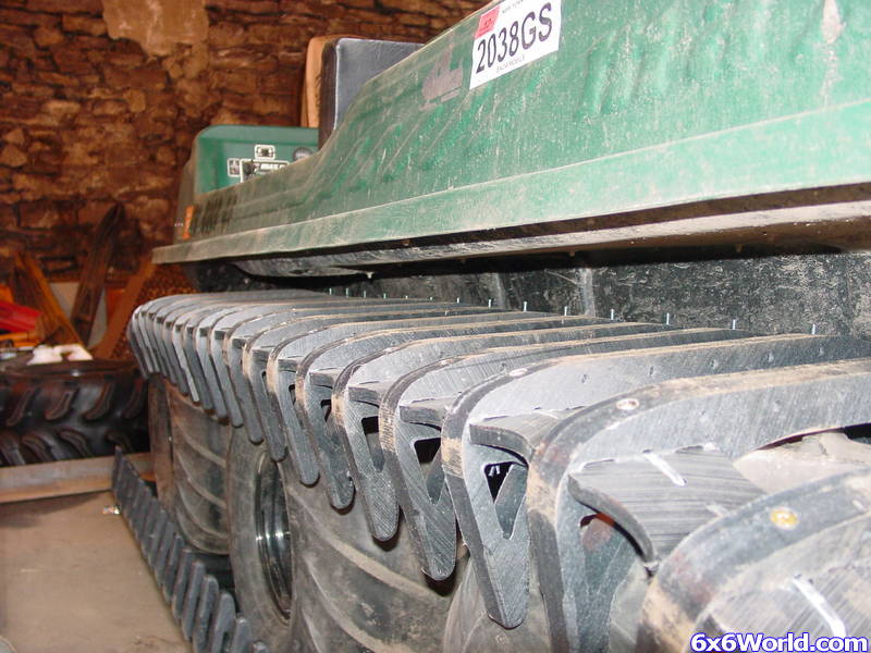

                I doubt you will have any problems Jim, with the pictures supplied by Buzz and Mark it is pretty easy to see why Buzz was having a problem. Here is a picture of how I understand the Adair grouser is supposed to fit a 25x12x9 Rawhide III tire
                I actually increased the amount of air I normally run in my tires to 7psi for these pictures to make sure I was close to what Buzz was doing on his Mudd-Ox. Buzz, it looks like you have the taller narrower 25x11.5x9 Rawhide III tires and maybe a bigger possibly overinflated set at that. Your grousers don't really even seem to fit the profile of the tires correctly. Elevated, Pro Series, Mud and snow, steel link, doesn't matter, all the Adair grousers have inner profiles designed for specific tires. With the amount of day light I can see between your tires and your grousers along with the small amount of wrap around your sidwalls I'm surprised you could drive straight without a problem honestly. I hope the Argo the tracks went on had tires that were a better fit to the grousers.

                Does the elevated design stay on better? I have not owned the elevated style but believe this to be true, however I will say that all other Adair style tracks stay on extreemly well when properly fit. I may not be the most aggressive driver but in my testing with my MaxIV I have never had my tracks come completely off. Even at Haspin this year when the bottom of the track curled under the bottom the track did not come off. To tell you the truth I do not think my machine has the power to throw a track off. Once the guide side of the grouser starts to try and compress an end tire my clutch will slip or the Kohler engine will stall. Sort of a built in anti track derailment system and I run my tires around 4-5psi and have about 3-4" of hang under my center tire. I really need to take care of that some day I guess. In any case if you really need to make certain the track has the least possible chance of coming off I would think the elevated track is a benefit as Tim stated. Is the elevated track cheaper to produce than a Pro Series? Looking at it I would say this is true. First you are using less belting. Second typically Adair uses fewer grousers on the elevated style because you can run a little greater spacing. Machine time is far less as you only use one tool and the profile is pretty simple. There is no fancy hinge plates on the elevated design like the Pro Series has only overlapping belt. The price of the fastening hardware required for the overlaping belt is slightly higher and assebly time with power tools is about equal when set up. Remember Adair sells and makes between 1-3 sets of tracks a day. They actually have it sort of figured out. And in a buisiness model you would probably need to figure in R&D time for the Pro Series and there would actually be none for the elevated track design as it is just a copy of a very old track system.
