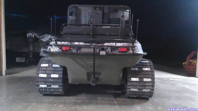

Thanks guys ya they were a little time consuming but didn't want the extra weight of still. I have been a welder and fabricator for 19 years so it wasn't to bad. I did make the guides 6" long after hearing guys on here talking about walking out of there's . And thanks again johnboy va for the help the 1" gap was right on.

Are you running 22's? Are you running extensions? Did you not run a hinge kit?
What was the length of the track as I am thinking of cutting a set down for my V2?sigpic
Demon72, I used 54 guides per track
Argo Jim, I am running 22x11x8 tires, Also have 1 3/4" extension on it without them only had and inch gap which wasn't enough for me, no hinge kit bolted them together using the flat pieces for the outside of the track, 4 pieces used to sandwich the track together. tracks are 167" long which left a 1" gap that worked out perfect. If you need anymore info. or close up pics just let me know. Jim
Thanks Hunterman06, if I'm getting the 1" gap you mention as a 1" overlap I'm at a good point.

and assuming the track butted flush would be 165".
I thought of that as I have heard not sure if true but some of your water speed is determined by how much of your tires are above the water. Again not sure how true but thought was worth a try never got around to it. Might help with the Adair tracks on the 6x6s as the 8x8 movre pretty good in the water. I get about 1/2 a mph per gps with those tracks. tires 4 mph. I have a bigfoot also was just a little disappointed by water speed with those tracks but have a trolling motor to help.
