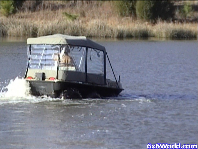

I have been designed/built and tested what I call a "Jet Wheel". It can be mounted on any AATV tire. It is a type of "Reverse Banki" design that produces thrust even if the tire is totally underwater. In the vids you will see it in action. It has been GPS'd at 3.0 mph. You can mount/dis-mount in 30 sec. When mounted on the rear tires of the Frontier it produced so much thrust that it was in danger of sinking the Argo! It also gives excellent directional control, and can be used with tracks.

that looks pretty neat.
Are they hinged, or, fixed vane?
It looks kind of like a squirrel cage fan? If so, how does it create thrust when submerged? I see it does, but, my limited little mind doesn't understand how they make you move so well if mostly underwater...............
I like how you made them just smaller dia. than the tires so as not to hit so much when driving on land while entering and exiting the water.
