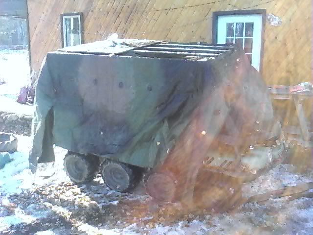

    The day I got her, just to give you a look at tire situation
      slime only makes the problem worse, it acts as a lubricant and helps the tire slide off the bead. your limited to 22" tires on that machine, so pretty much limited to 8" rims. some K-locks from recreative would work well. your tires are also a good part of your roll pin problem. they are 2 different sizes and that makes them want to roll at different speeds. they can't because they are connected by the chain, so either a tire has to break traction constantly, or the roll pin has to break. i'd still replace roll pins with bolts though. come to think of it, your tires are probably spinning on the rims and that is helping them break beads too. take a red paint pen and mark each tire and rim, then go for a short drive. i bet when you stop some of the marks won't line up.

        The front and rear end of that machine is sagging with tires being bigger in the middle. ouch

            Larry, i doubt that 24's will work. those early 80's argo had less clearance than a conquest. the center tires look a lot like the ones i had on mine. if i had to guess, i'd say those are 20" runamucks on the center that have some broken bands (judging by how round the tread area is) and they are stretched to about the same size as a 22" runamuck. they are almost touching each other in the center, and are probably just about rubbing the body too
