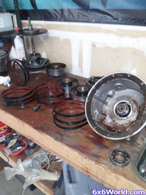

I finally got the trans out of the hustler today-

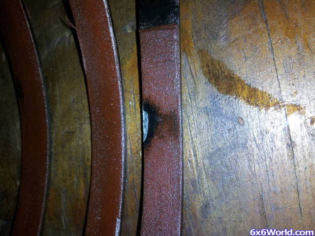

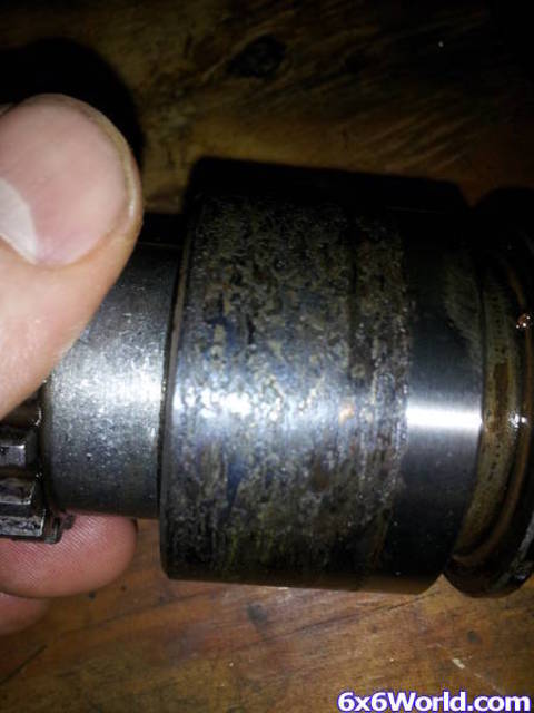

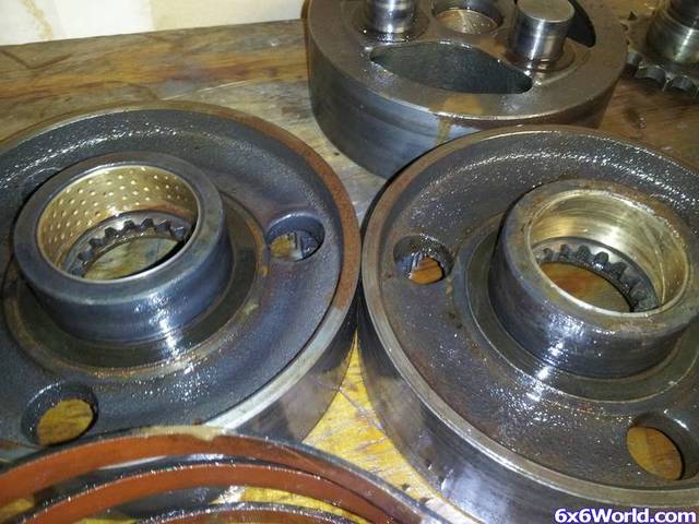

there was a bad bearing that let one piece gall a gear, one drum that has light surface umperfections, and the bends had a 'hot spot' in one place, and are going to get relined...
im afraid that one piece ain't gonna buff out- see pictures..
